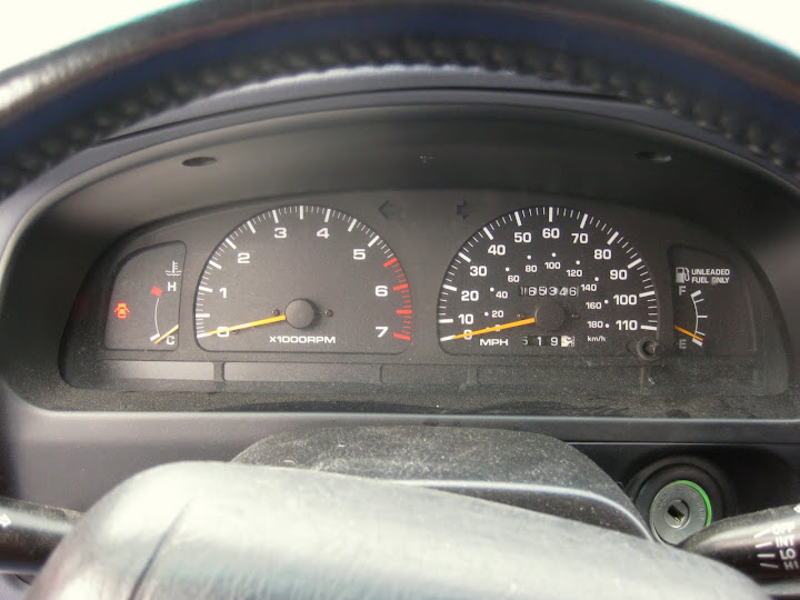

Here's a photo my dash panel. When I engage/dis-engage the lever (photo below), I hear a click. 4WD apparently engages/dis-engages likewise, but I don't see any light anywhere to indicate when 4WD is engaged.

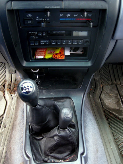

and shifter configuration...

...still trying to verify that there is a light. I don't see where it might be.
Below my fuel gauge??
Yes there is a light for it, shine a flashlight around the dash area and you should be able to see the outline of the icon of what were saying.
Remember, two things have to happen for 4WD to engage on your truck (more on other models). One, the TC has to engage the front drive shaft in 4H or 4L. Two, the ADD system has to engage the front differential to the front wheels. The light only comes on if BOTH happen, and #2 only happens after #1 happens. To be sure you are in 4WD, do you feel the tightness in a slow turn on asphalt? If so, and no light, then sending indicator switch on front diff is your probable culprit. If no 4wd, then problem can be in ADD or TC. Lots of posts on troubleshooting this if you search. But first be sure if you have 4WD or not--don't rely on a 'click'.
