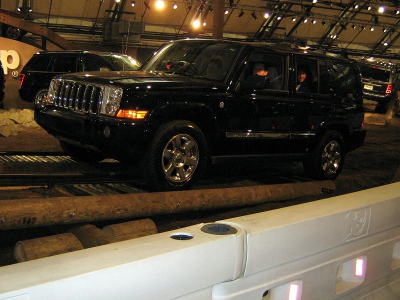

Did anyone get a chance to check out Camp Jeep at the New York Auto Show?
They had an obstacle course for the different Jeep models that includes articulation, water fording, ground clearance steep ascent/descents etc...
Anyway, they also had an interesting set up to show the traction. Basically, it was an inclined ramp with a series of rollers. They drive up the ramp and stop with 3 of the 4 tires on the rollers and only one wheel on the ramp. Then they demonstrate how the one wheel will get enough torque to move the vehicle across the ramp. There are two sets of rollers; the first one provides traction to the right rear wheel only and the second set provides traction to the left front wheel only.
How would the 4Runner do on that type of situation?
Here's a pic of the ramp set up.
