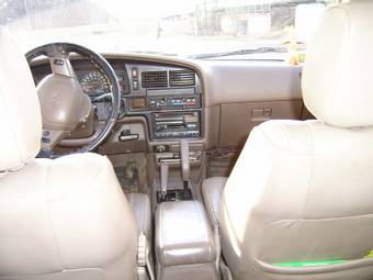

I took this to mean MANUAL LOCKING HUBS... but you say he has auto-locking hubs .. and now he agrees with you .. I guess his "manual" was referring to his transmission (don't know why his transmission would come into the conversation)
Yes, manual was in reference to the transmission. I only brought it up because the auto and manual shifter assemblies for the transfer case look different on the 2nd gens. The manual has a J-pattern shifter while the auto has a straight pattern. I don't know if the mechanicals and warning systems are the same between the two, but I figured it was worth asking.
Auto shifter assembly:
Manual:
80947d1271130320-1995-4runner-4x4-tan-interior-trim-around-manual-shifter-4runner_shifter_trim_simple.jpg
