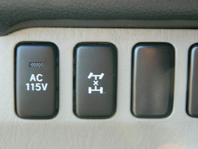

Hi there,
How do I lock the differential? how do I know if my 4R has such feature? that would be awesome.
Thanks
Hi there,
Thanks
Look for this button on the left of the steering wheel.
Push it to lock the center differential.
