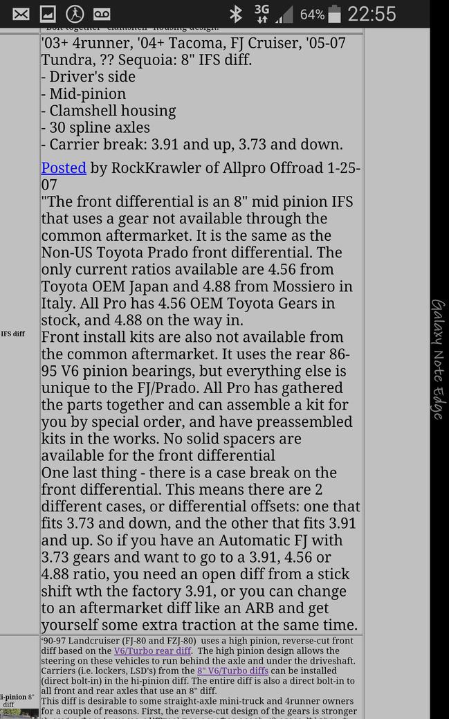

You can take a front Diff from tacomas, 4runners, or FJ cruisers for sure. You just have to be careful to get the right gear ratio. Also, if you plan on re-gearing to anything lower than 3:91, you need to be cautious to get the right front diff as there is a carrier break, and 2 different internally designed diffs for Tacoma's and FJs.
The rear is a standard 8'' Toyota rear end, and will accept most Toyota 3rd members. Axles are 30 spline, so be sure that the spline count matches if you swap the rear 3rd. If you have any gearing aspirations anyway.
