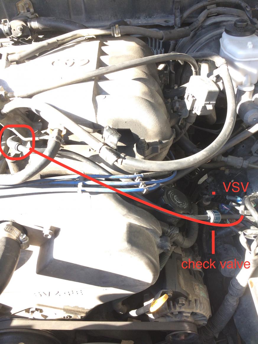

Hey guys, I'm reviving this old thread because I have yet to find an answer after searching/reading through several threads on the topic. My ADD isn't engaging correctly and thanks to all the information i've gleaned here I was able to identify that the issue is Vacuum.
I've tested the VSV's, the actuator, the check valve, and T-case. All are working normally, but the system isn't getting any Vacuum from it's source. I traced the lines to a round thingy on the back side of the intake near the firewall and put a vacuum gauge on it with the engine running. There's no vacuum coming from it. What is it? I can't find it in any diagram of the engine's Vacuum, or 4wd components. It looks like there's another hose that comes out of the bottom and maybe runs to the gas tank but it's really hard to see back there.
I plugged the vacuum line with the check valve in it into another port on the intake that did have a measurable vacuum on it and tested the 4x4 system. Everything worked, however this is not a permanent solution. Does anyone know what the round thing is on the back of the intake that seemingly has no vacuum? I'm not pulling any codes and the engine is running normally.
I've included a picture of the part in question. Please help! Thanks!

vacuum hose diagram should be on the underside of the hood...
that looks like the fuel pressure regulator. Vacuum goes to it, not from it.

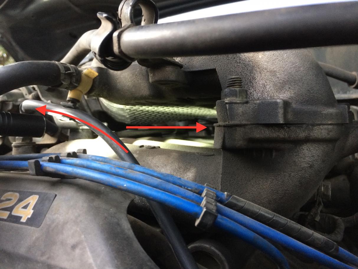

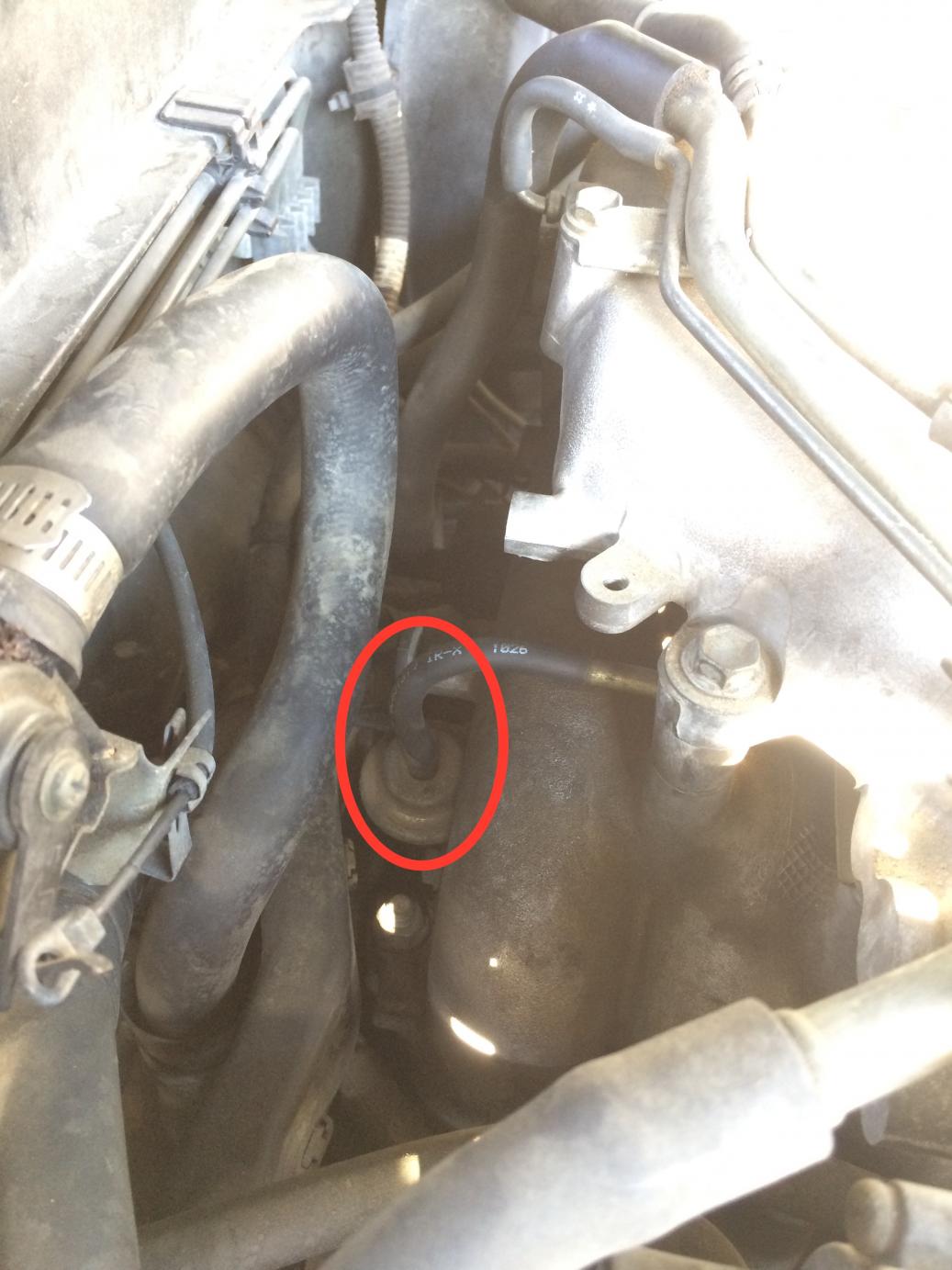

Alright, this is helpful. My vacuum line runs from the VSV to a metal tube at the front of the intake. The metal tube runs all the way to the back of the intake between the upper and lower sections of the intake. At this point a rubber vacuum line connects it to what you guys are telling me is the fuel pressure regulator. I found a vacuum diagram but I don't see the VSV's on it anywhere. Where should the line from the VSV's plug into if not this tube? My 4runner is a 98, auto transmission with the J-shift T-case. Here are more pictures for clarification. Thanks for the help guys.
