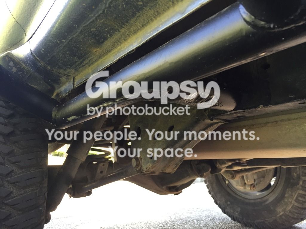

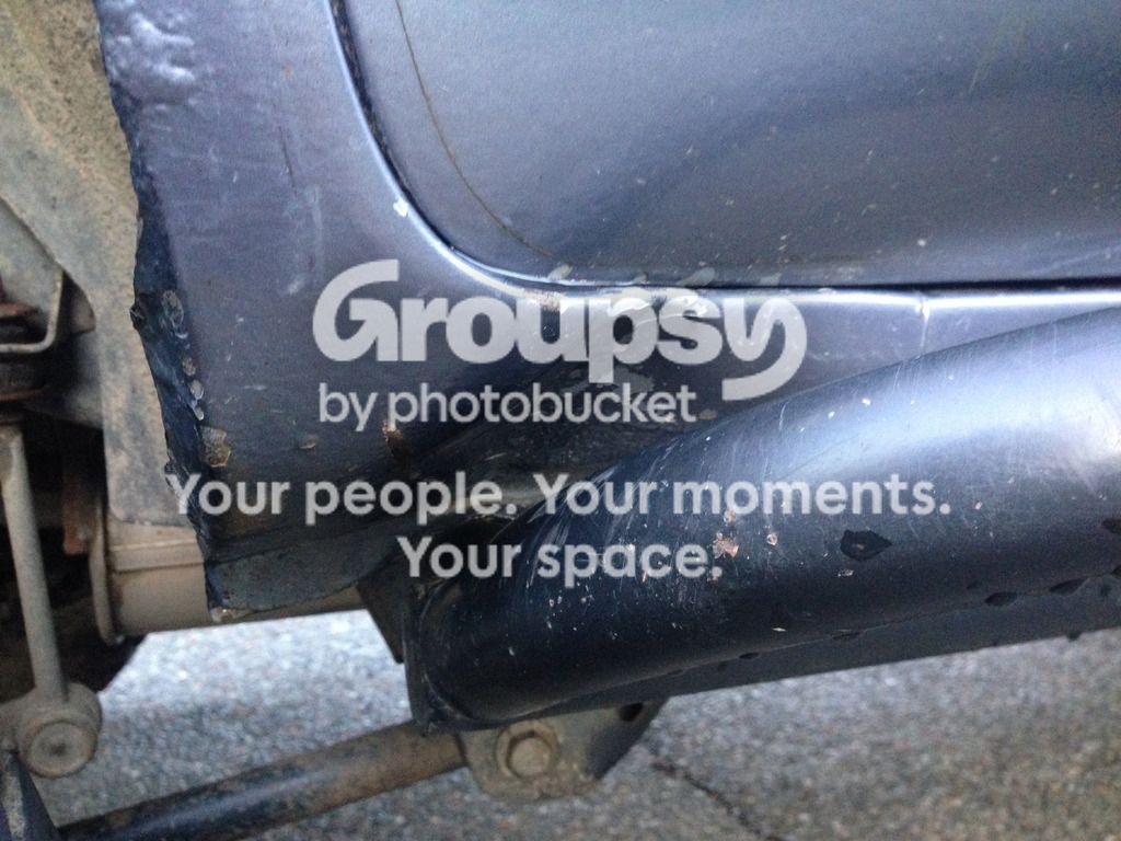

I hate to say it but these sliders are not very strong. Mine keep bending up. Even after bending the passenger side back down and adding the biggest gussets I could fit onto all 6 legs, its bent up again and the kick-out is millimeters from preventing my rear door from opening. One more good hit and I don't think I'll be able to use that door. I had them welded on by a reputable shop so I don't think the welds are an issue. When I purchased these, I weighed them and they came out to 28lbs each which seems pretty light for sliders. I don't think they are a poor product. They are just maybe a bit too light duty.
That is so weird, I've been up on both the rock sliders, on the one side there was at least one wheel in the air, so I had quite a bit of weight on them, and I know that I couldn't have had hardly any deflection at all. I know this because I'm very close to my fender flairs and the body at a couple of points.. Like a 1/4 of an inch and they didn't touch anywhere. So far I've only slid off of them at pretty slow speeds. I haven't bounced them off anything yet, but I'm sure eventually I'll misread a line and drop them on a boulder or something.. I hope they don't bend when that happens.. They are pretty darned beefy though, I can't see these bending or denting at all.. I paid for the upgraded tubing when I bought mine, I think it was $50 extra. Maybe that is the difference? So far I'm very happy with these.. I'll post an update if I do see any issues in the future though!
I bought mine about 3 years ago. Its possible that they have been improved since then.
Hard to tell from the pics - but how big were the gussets? My sliders came without any so I am making some.
Are your sliders bending or is your frame collapsing where the base is welded on?
