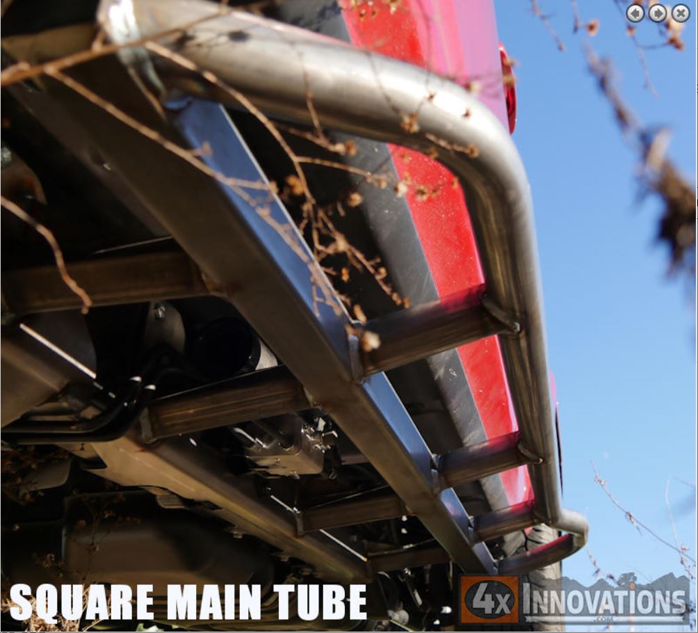

These look really beefy. Anyone running them?
Like the mounting setup, DOM outer tube, price, the amount they come off the body.
Don't like how it seems they have removed the kdss skid plate (that could prob be fixed with a bit of work).
2010 - 2019 4Runner Bolt On Rock Slider

RSG does not list them as DOM. They look good tho.
DOM tubing is NOT stronger than an ERW tube of the same material. This is just a marketing trap for people who don't know better. Kinda like how the word BILLET makes all the flat bill bros go crazy.
The process of creating a DOM tube is taking an ERW tube, heating it, and then drawing it over a mandrel to get a more precisely round and accurate tube. It will be more dimensionally accurate and round than an ERW tube, but not stronger.

Based on the video, it looks like the KDSS skid can bolt on right over the slider into the original factory holes. The protrusion/hook that holds the skid in place before the bolts are installed should still fit through the large hole in the slider mounting bracket. Probably need to bend it a little.
You may need to grind a little of the skid away where it wraps around the slider. I had to do that to fit my RSG sliders. Five minutes with an angle grinder and some spray paint was easy enough.

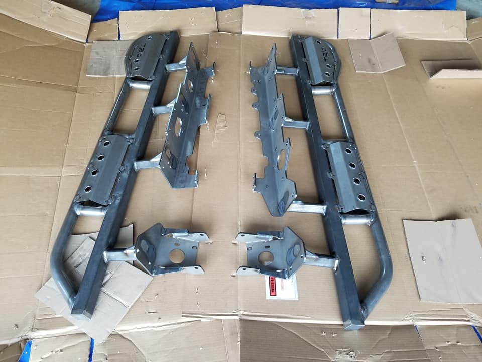

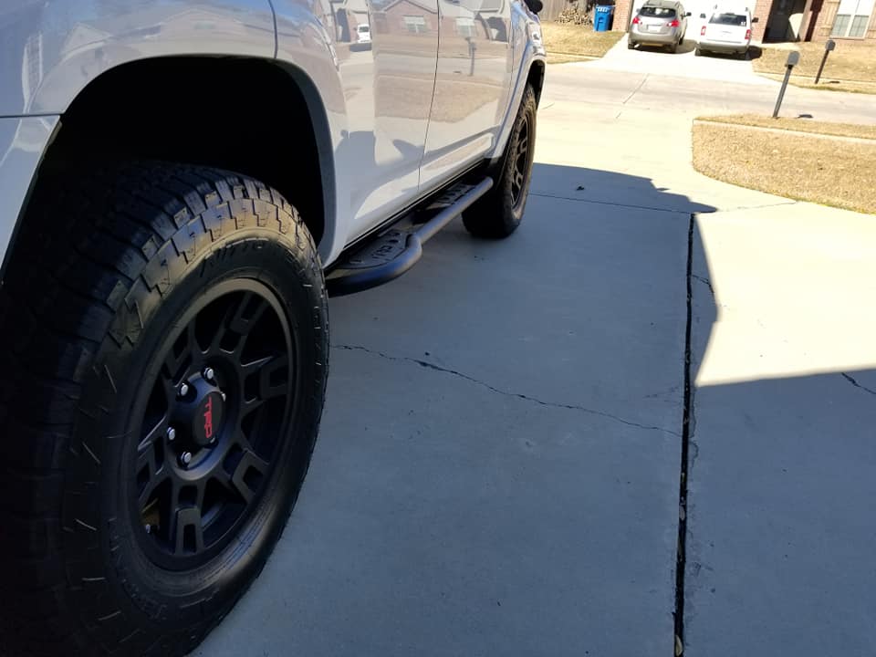

I have them and love them. I haven't been able to really test them yet, unfortunately.

I went with RSG angled, no kickout, no top plate, powdercoated for under $700 shipped.
There are videos on youtube of people using RSG sliders way harder than i will ever use them.
They look great, are fairly cheap, and are the most expensive step i have ever purchased for my wife. I doubt ill ever need sliders, but she will use them every time she climbs in.
