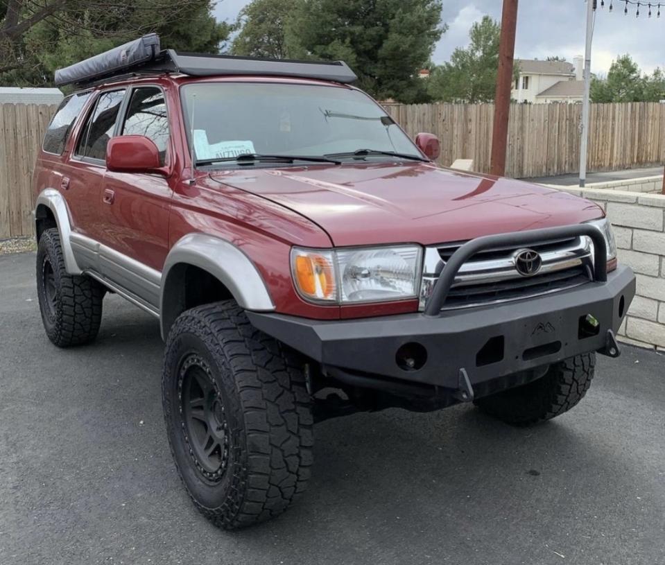

Being a poor bastard , I ordered a welded TNF plate bumper of very similar configuration (pic below is not mine, it popped up on my IG tonight as I follow TNF - shipping soon, after 18(!) weeks) during the Black Friday sale mainly because they use Affirm as a fairly painless payment option. Not to share too much, but I have 2 kids in college and no generational wealth to draw upon. Their base prices have increased somewhat since then (I also got free shipping and approx 20% off overall, so I opted for their powdercoat with the 'savings') Same config as the pic.
Cons: I will need to trim back my frame rails by 2" but fvck it - not going to return to stock and keeping my rig til I die. 18 F'ing weeks!! - can't imagine what Addicted Off Road's lead times are nowadays. Sheesh. Got a washer fluid relocation bracket/tank coming from Scarab via Opt Off Road as well. Gonna rig turn signals till I figure something out.
P.S. If this is your red LTD - thanks for the pic! The photo credit belongs to native_4rnr on IG according to True North Fab.
Edit - I forgot the price: I paid 1304 shipped (extra 300 was PC cost). I just went through their cart and current price would be 1,729 for welded by them, high hoop and powder coat shipped - yikes. The difference is mainly BF discount/shipping + slight base price increases.

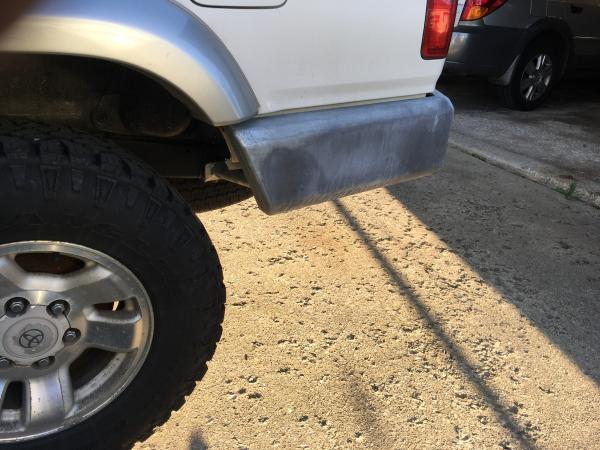

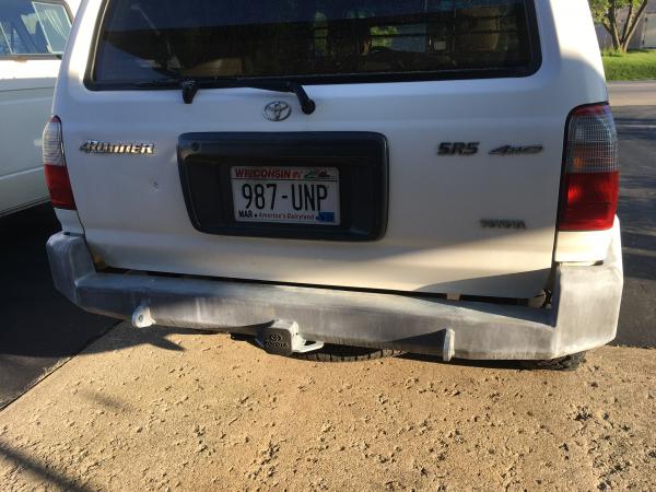

I purchased my 4xinnovation basic bumpers on Black Friday, 11-2019. I live about 2-1/2 hours from Platteville, WI, which is where the production facility is located. I was able to save the shipping costs, was able to meet Adam and Ben, and tour their facility. Well worth the drive.
The bumpers sat in my garage until spring while I debated what finish I was going to use. SE Wisconsin is in the heart of the rust belt, which was the reason for replacing the bumpers in the first place.
After much research I ended up contacting a hot-dip galvanizing shop nearby in Milwaukee. They have a wide array of contracts, notably boat trailers for inland boating. I made a visit, got some details and requirements, and was quoted a price. $125 plus tax for both bumpers. Apparently, they have similar requests about once or twice a week for this service by local guys. The only request they had for me was to drill a few 3/8" venting holes in strategic spots so the bumpers would be uniformly coated in the dip tank without any puddles in the bumper when removed.
The bumpers turned out great. I installed them about two years ago, so they have seen two rust belt winters and show no signs of any rust whatsoever. During installation I sprayed Fluid Film in neighboring areas of the body to fend off rust, as well.
My grand total for both bumpers with galvanizing was about $1400, not including gas, beer and burgers for the product pickup.

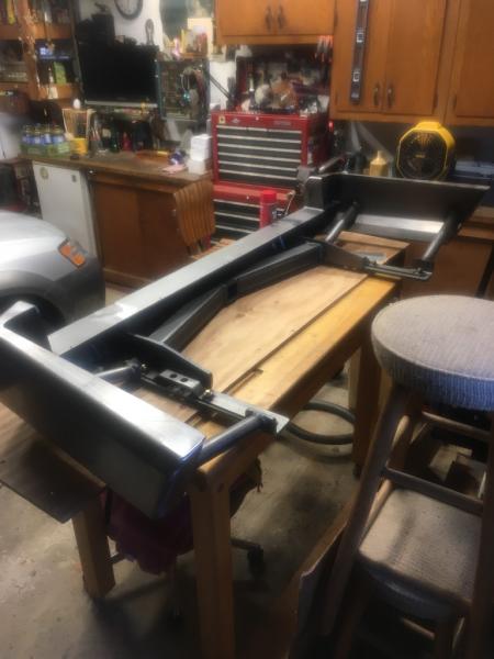

The rear bumper was a less difficult install, and they do not have instructions on their site. It also required the balancing act. They do provide bracket strips for the welded captive nuts that go inside of the frame rails, which made the install quite easy. Fortunately I still have a couple pics on my phone to show. The strips are bolted loosely to either side of the bumper in this pic. If you choose galvanizing for a finish, make sure to drill and chase the threads for all of the fastener locations.
riceye-albums-ric-s-pics-picture61818-67c8a415-6edb-47e6-83ff-2c905eefcdac-1-105-c.jpeg
One more point worth noting about the 4x Innovations rear bumper is that it replaces the factory hitch. The integral hitch is class 3, rated at 500lb tongue load and 5000lb for towing. It is beefy. The receiver is higher than the factory hitch, and will require a ball mount with greater drop to level your trailer.

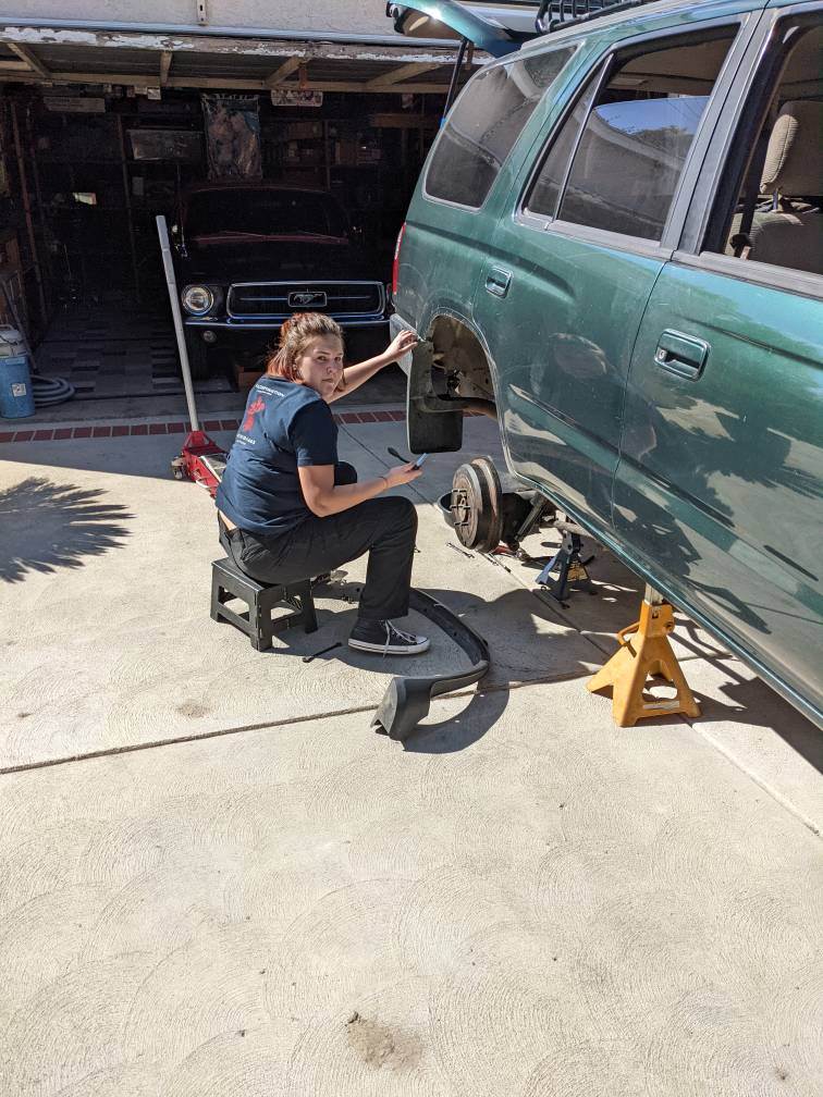

Bonding time doing something with dad and boyfriend.
I can ask and see if I get less than the usual eye roll. Here she is on fender flare detail
