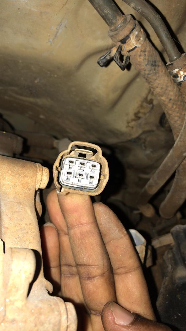

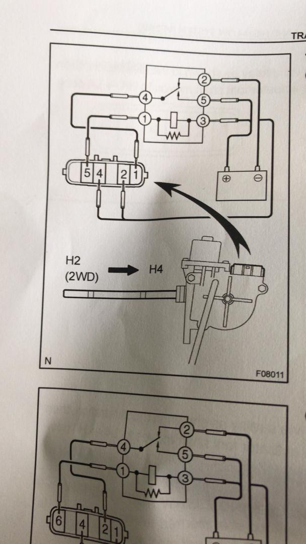

Hi Charlie,
Thanks for this info, very grateful.
So the VF3AM transfer case is the same for the multimode 4x4 surfs?
The guys at Toyota here saw that the connector socket on my actuator was different from the one in my car (6 pins in a row, while mine has 2 rows of 3 or 4, something like that) and they deduced that the transfer case must be different...
Thanks again,
Fabrizio
Here is the pics, the connector from the manual versus the connector in my actuator, held by the Toyota mechanic.
This is what made them think that it's a completely different transfer box...
