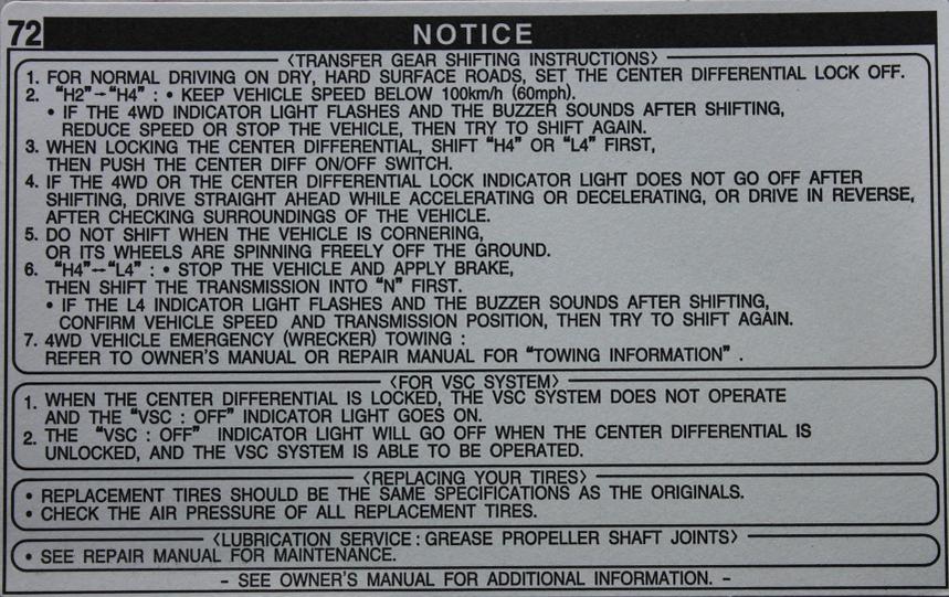

I have driven 500mi in terrible weather at highway speeds in my old V6 04 and not a single issue. I also had a 2015, which is true 4wd with locked center diff, and have driven that at high ways speeds in 4wd. The trick is not turning, as when the center diff is locked all the wheels are locked at the same speed. When you turn the wheels begin to turn at different speeds, and if they’re locked it creates binding in the dif. A good rule of thumb I once read on the 5th gen forum is any turn you can make at greater than 30mph should be ok. And from my experience in my 5th gen, that was solid. If there was binding, I could feel it release when I shifted back into 2wd, and didn’t have any issues adhering to that rule of thumb.
But as others have mentioned, this isn’t a concern in the 4th gen, unless you lock the center diff.
