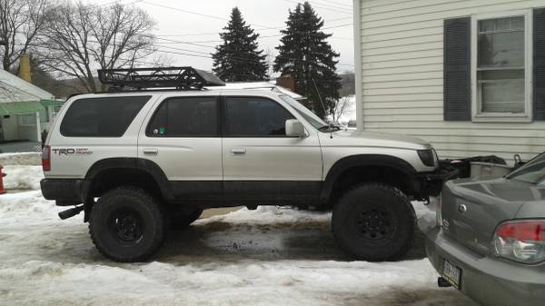

Alright folks, I have a few questions pertaining to the 2000 T4R SR5 V6 5 speed I just picked up today.
2000 4Runner with 181xxx miles, will go up slightly (driven daily)
-6 cylinder, desirable 5 speed manual transmission shifts smoothly
-New inspection, battery, front axles and bearings
-SR5 package includes push button differential lock
-Fully loaded, sunroof, all power, flip-out CD/DVD player, all options except leather. Nice clean interior
-Six inch suspension lift
-Aftermarket wheels and tires (35's in fair shape - good bit of life left)
-Aftermarket front bumper and roof rack
-almost new 8000lb smittybuilt winch
I absolutely love the truck and being that it is my daily driver I look forward to correcting any minor issues such as dents, scratches, and paint. My questions revolve around the frame and mechanical aspect of the rig. I am not a mechanic but I like to know as much as I can about the vehicle I choose to put myself, my loved ones and most importantly the love of my life in on a daily basis. Any and all answers are greatly appreciated.
Here we go.
As you can see in the three pictures I uploaded of the truck is in total working order. My questions:

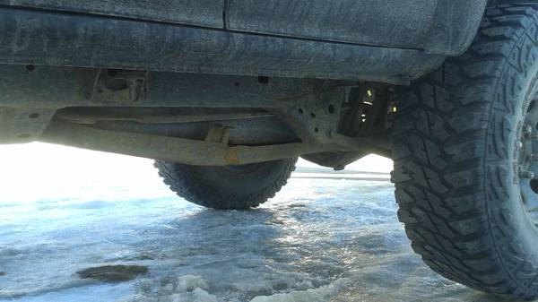

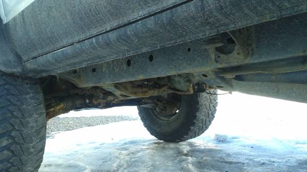

There is surface rust areas all over the under body/frame, can I just oil-undercoat it and be good or is there another process to add in order to keep the truck from rusting out?
The timing belt has already replaced at i believe 140k miles but with 181k miles is there anything else I should have checked out by my mechanic before long trips or off-roading that these trucks are known for having issues with? All of my research has led me to dead ends.
Is there anything regarding the tranny, axles, or 4wd system I should keep an eye on?
Finally, are there any relatively cheap add-ons that you folks would recommend to aid in daily driving?
Any and all knowledge on this rig is greatly appreciated!:lookout:

With the rust surface rust I've tried lightly prepping surface and spraying with Eastwood rust encapsulator, but after 6 months small rust spots start showing through. Recently purchased a can of fluid film from local advance auto to test and so far I like it.

Your gas tank skid has been smashed in along the front edge. It is not supposed to have that v shape. Subsequently, your tank may also have some damage.
I would be weary of the fresh front axles. Trying to turn 35s offroad on any CVs other than OEM or upgraded aftermarket axles typically results in breakage. Its possible that the front suspension is too tall, putting unnecessary stress on those axles. You may want to look into getting OEM axles, the boot slide mod, and/or lowering the front suspension.
