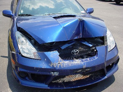

I wouldn't count on that. I have horrible luck with new cars, here's the result of a drunk driver, the airbags did not deploy and I was going about 50... Neither did the ones on my tacoma. I'm not picking on you guys, just giving you a hard time.
