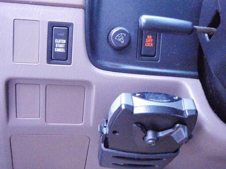

Not all 4x4's were locked, mine isn't, i have a 5 speed manual with the V6 it is a lot of fun. I get about 17mpg mixed in the winter and 21ish in the summer. Look to the left of the steering wheel for a button that says something like "RR Diff Lock", and the 5 speeds are kinda rare and no one sells um, and if you find one it may be more $$$ than a comperable auto, but the 5 speed in these are bulletproof.

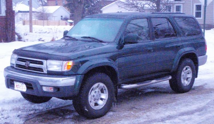

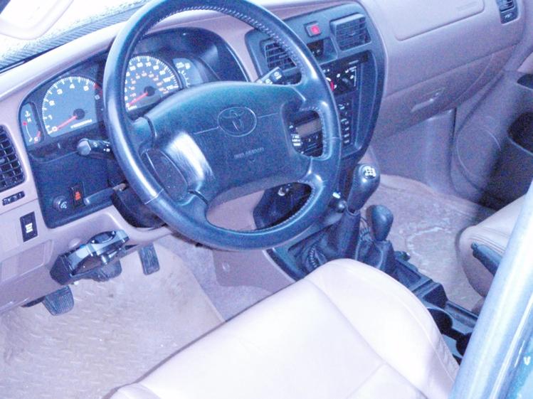

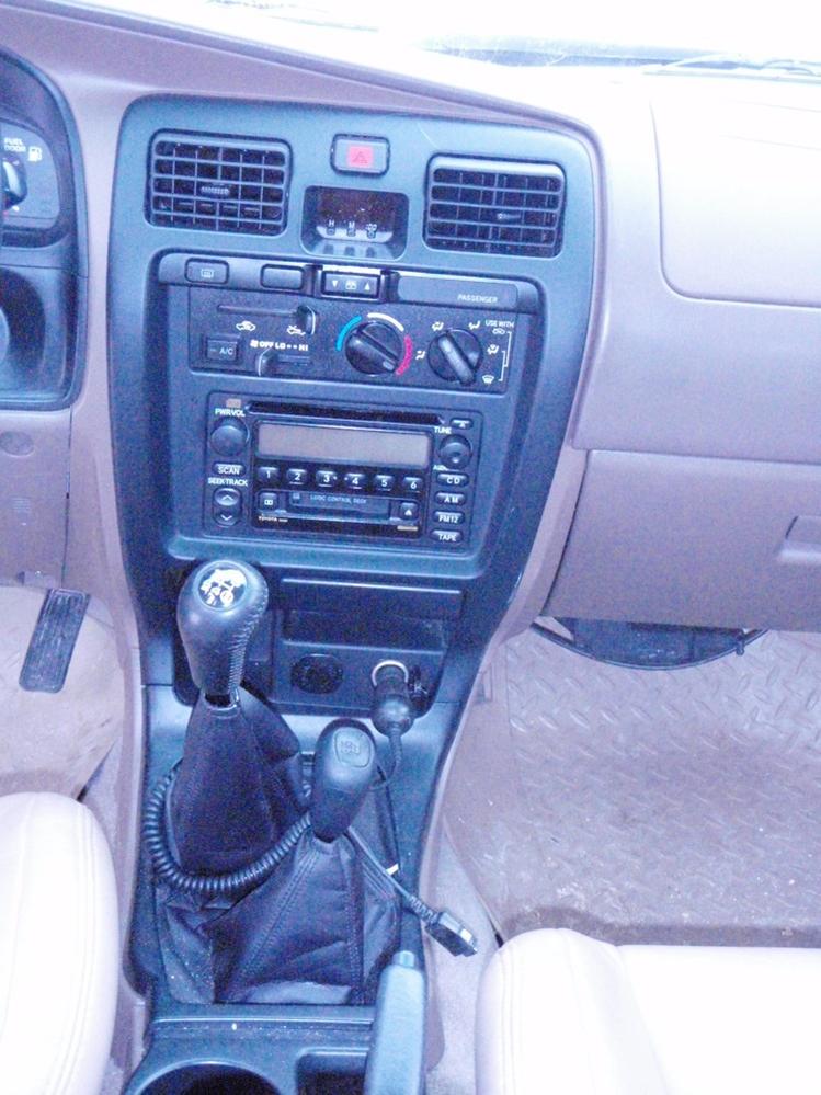

My 2000 has a 5 speed with E locker. During the summer of 99 we saw several at a dealer in Lander,Wyoming and found ours in Colorado Springs. The dealers in Wisconsin claimed their buyer group wouldn't stock them for Iowa, Minnesota and Wisco. Too bad for everyone else, I got mine.
