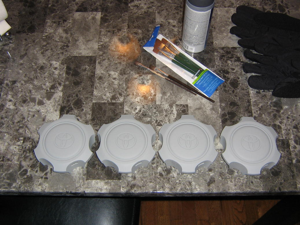

The best way to clean them, especially the insides is to throw them in the dish washer. Don't forget to use plastic primer & get all of the old paint off. I did my split 3's in a matte grey. I still need to hand paint the logo's in silver.
