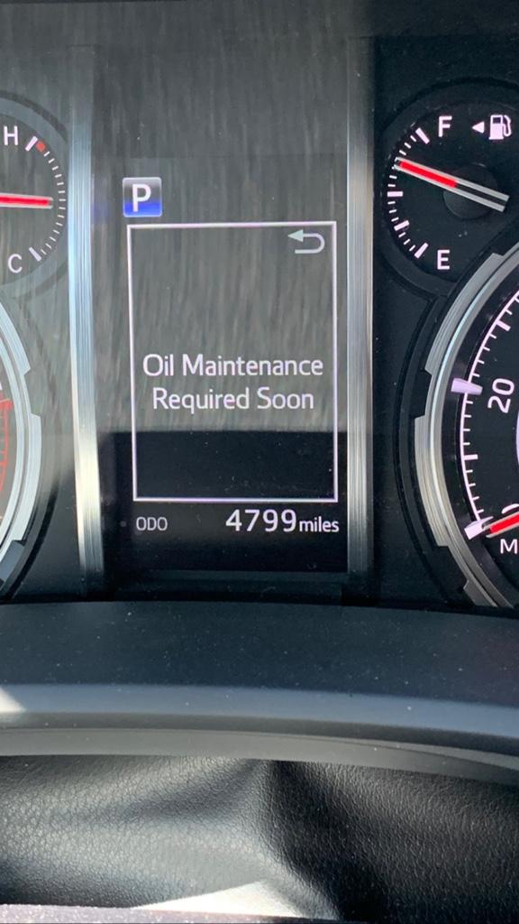

Look at what my 2020 shows with less then 5000 miles. My dealer said no oil change till 10k so
I showed them the pic and why does it say “oil maintenance”. He couldn’t explain why it says that but said not due till 10k. I paid for the oil change myself. Was going to anyway just for piece of mine for break in period.
