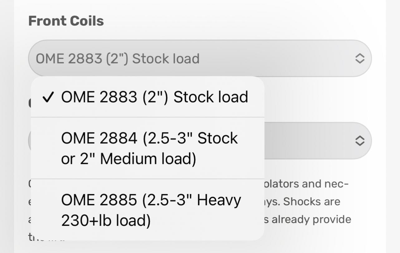

I have 5100s on both front and rear of my 5th gen 4Runner. Have about 150lbs of weight on front (winch and bumper). Currently set at .85 with stock coil. Want around 2.5 lift in front. Would 2885 OME coils on lowest setting do the trick?
Have JBA UCA and ICON 2" rear spring waiting to be installed as well.
CHEERS!
Here are the coil overs I just got. OME over 5100’s and the spring they recommend for each weight. This is sold as a 2.5” lift. This is on a 5th gen
