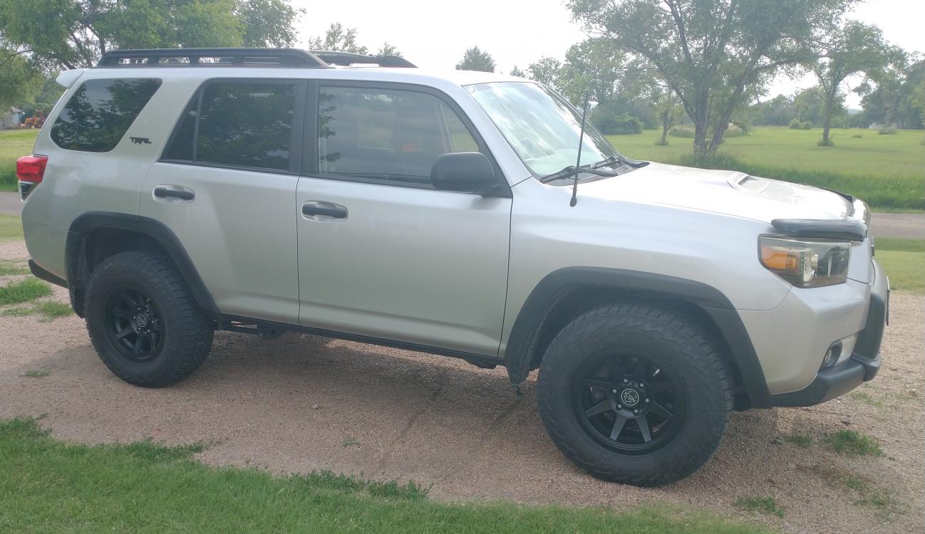

I just went from a declining x-reas to 5100's all around. Front set at the 2.5" lift setting with stock springs and I added a Cornfed 1" spacer to the rear springs. Measured from the bottom of the wheel well to the ground (directly above the wheel center caps) the rear now sits at 38" and the front is 37". Only had it a week or so but so far so good. More feedback, more planted, less rake, ready for 33's.

This is what I needed to hear! Saw a YouTube vid and guy complained about ride at full 2.5” height in front.

I've seen some negative comments as well, went back and forth between 1.75 and 2.5 for a couple weeks but decided that was the stance I wanted and if it was bad I could always switch. The steering feels slightly 'lighter' but there's more feedback and it feels more responsive (without being 'darty'). Had always seen people complain about nose dive but didn't think it was as bad as made out to be, have been VERY impressed in the few harder braking instances after installing the new shocks.
