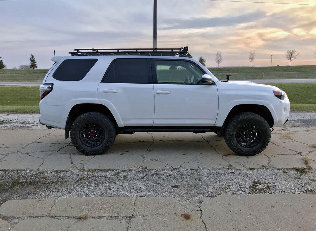

I posted these in a previous thread. I've got Bilstein 5100s with the front adjustables set to 1.75" and a pair of stacked 10mm OME trim spacers on each rear coil.
Cowtown did your rear kina seem noisy at just really slow speeds over small bumps? I just did your exact setup and have checked everything multiple times but the rear seems quite noisy on slow small bumps. If im going fast everything is really quiet. Not sure if it has to do with the valving of the 5100s or what. The rear is tow OME 10mm apacers, bumpstop then coil. Spacers sit against the frame. Any help would be appreciated. Thanks!
