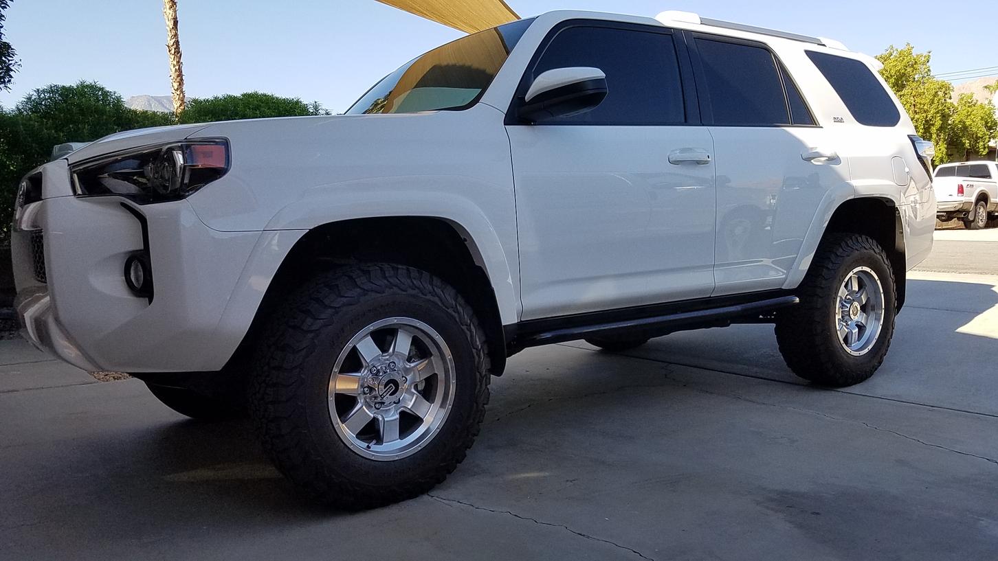

5100's Installation + Daystar 1.5" Spacers on a 2014
I got 1.75-2" of lift in the rear with the SAWs. That seems to be the consensus with others that have installed them as well. I think it's the perfect match to 3" of lift in the front (perfectly level frame rails, about 1" rake at the fenders). With 285/70/17's, I'm right at 39" in the rear and 38" in the front (ground to fender).
