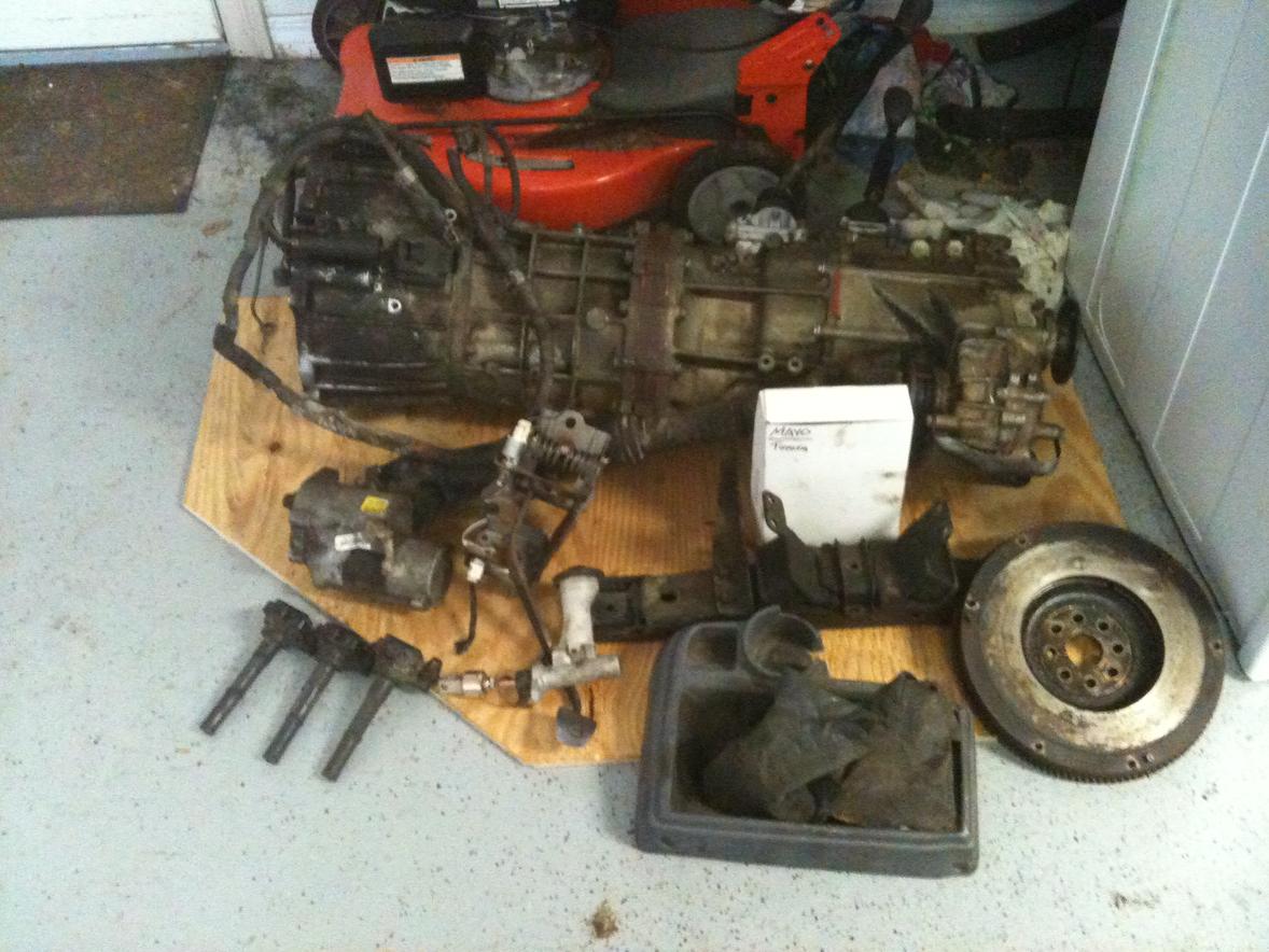

I think I have enough parts to start the swap thread now. I went and picked up the donor 98 5spd, t-case, front drive shaft, flywheel, master cyl, clutch pedal, new in box ECU, cross member and center console. Guy also threw in a starter and a few coil packs. Got all that for $400 and spent about $100 in gas. The wife's 04 Forester 2.5XT was gettin it, cruise maxed out at 90 and managed 18MPG. Still need STi turbo, intercooler, intake, exhaust and a COBB tune but that's for another forum.
Still need to get a clutch, slave cyl and build a clutch line. My auto is almost ready to pull just got the 6 bell housing bolts, cooler lines and the cross member. Wish I had a trans jack for this! It's gonna be fun:hungry: I'll get pics up later today.

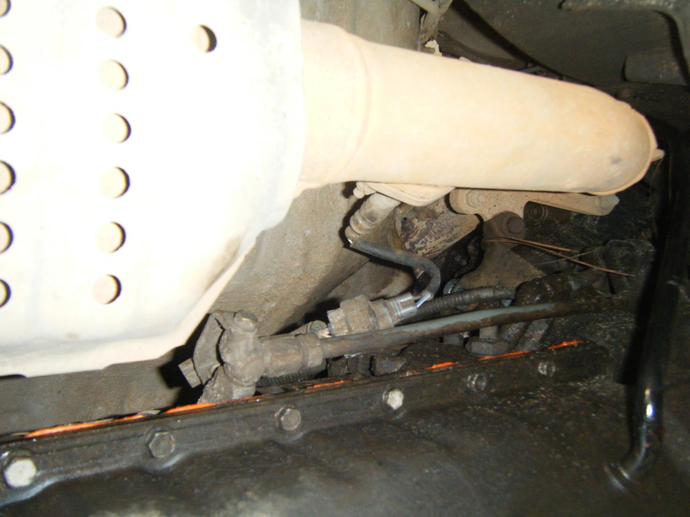

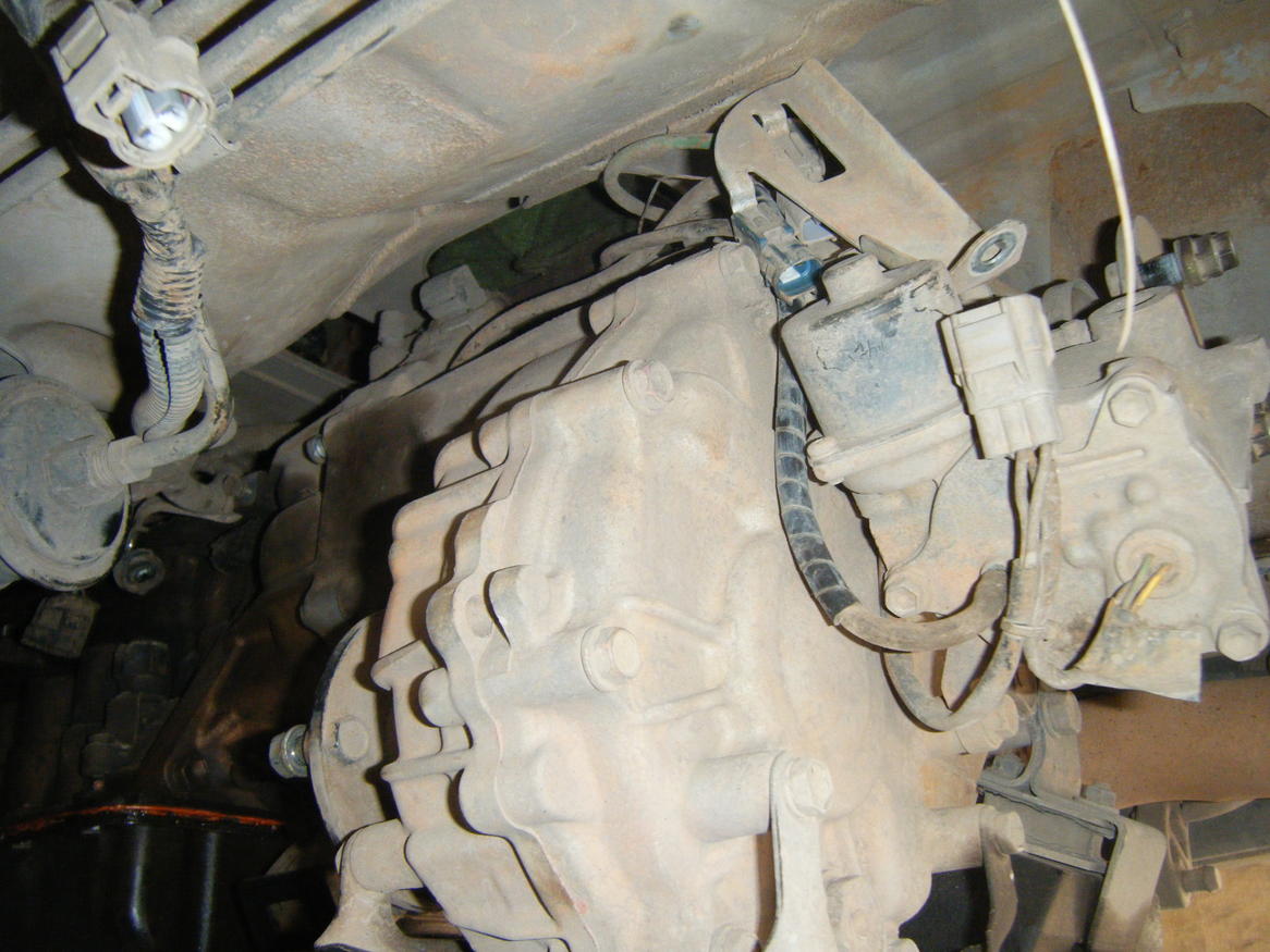

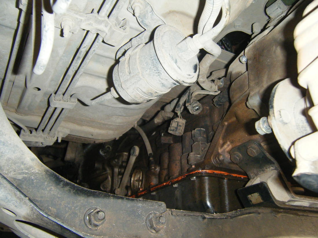

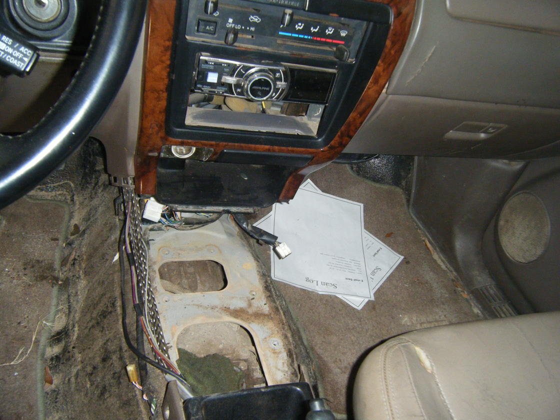

Jan 3rd Progress update- All that's left is 2 cooler lines, 6 bell housing bolts and drop the cross member. Taking my sweet time. The torque converter bolts were the worst part so far. Just hard to get at. So far so good. I know it's dirty! Shes been collecting dust for 4 months and burped up a few qts of trans fluid after I purposely overfilled it. Can't wait to get some fresh mud on her!

Got a little bit done tonight, all the hard stuff is done. Cooler lines removed, trans is held to the motor with the two lowest bolts only and the cross member just has the outer bolts keeping it in. Ready to drop it tomorrow. Probably gonna lower it with my big floor jack with the assistance of a few ratchet straps hung between the frame. It's worked in the past.
If Toyota had put half the effort in designing the radiator as they did routing and securing the cooler lines then I wouldn't have this problem! Lines are bomb proof!

Got the trans down last night. Went pretty smooth with my makeshift trans jack (plywood bolted to my jack) and only one set of hands.
Two plugs that I didn't see until the trans dropped a bit, no harm done.
Just removed the jack pad and bolted a piece of 1/2 ply to it, worked out perfect
Obviously the valve cover gaskets need to be replaced, but I didn't know it had gotten that bad! Looks like the crank is good and has the place for the pilot bearing. Gonna do the rear main while it's out too.
