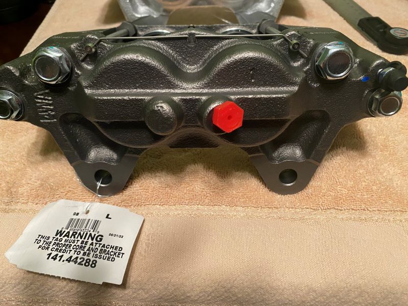

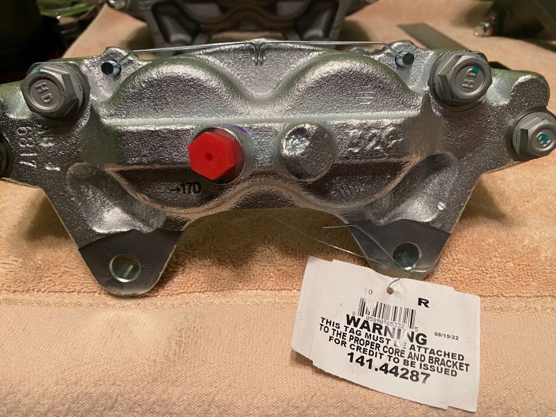

5th gen Calipers (left)
(Right)

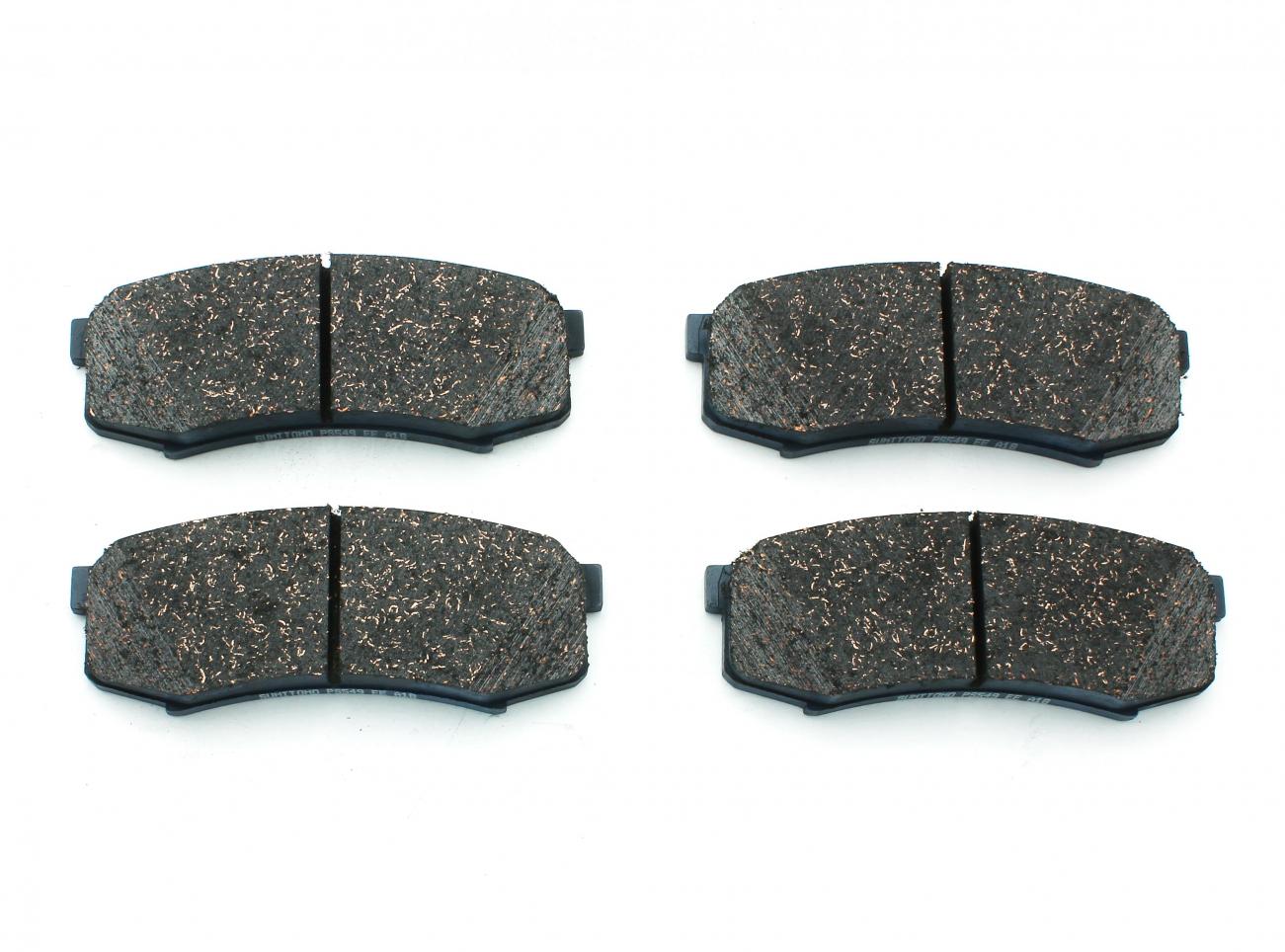

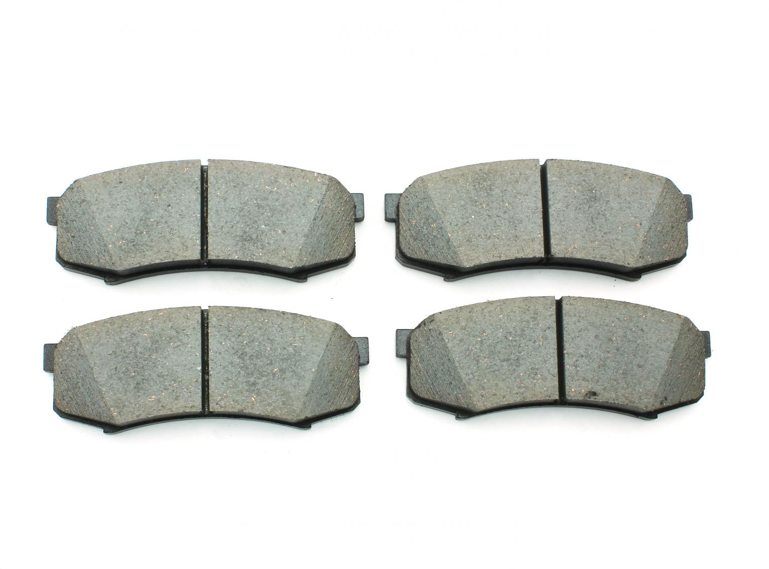

Visually, the pads are clearly made of a different material. The shims are quite different as well. It seems more logical to use the 4th gen pads with 5th gen shims on the 4th gen discs with 5th gen calipers but I couldn't be sure.
Does anyone know the REAL difference or have an answer for this? Thank you :)
