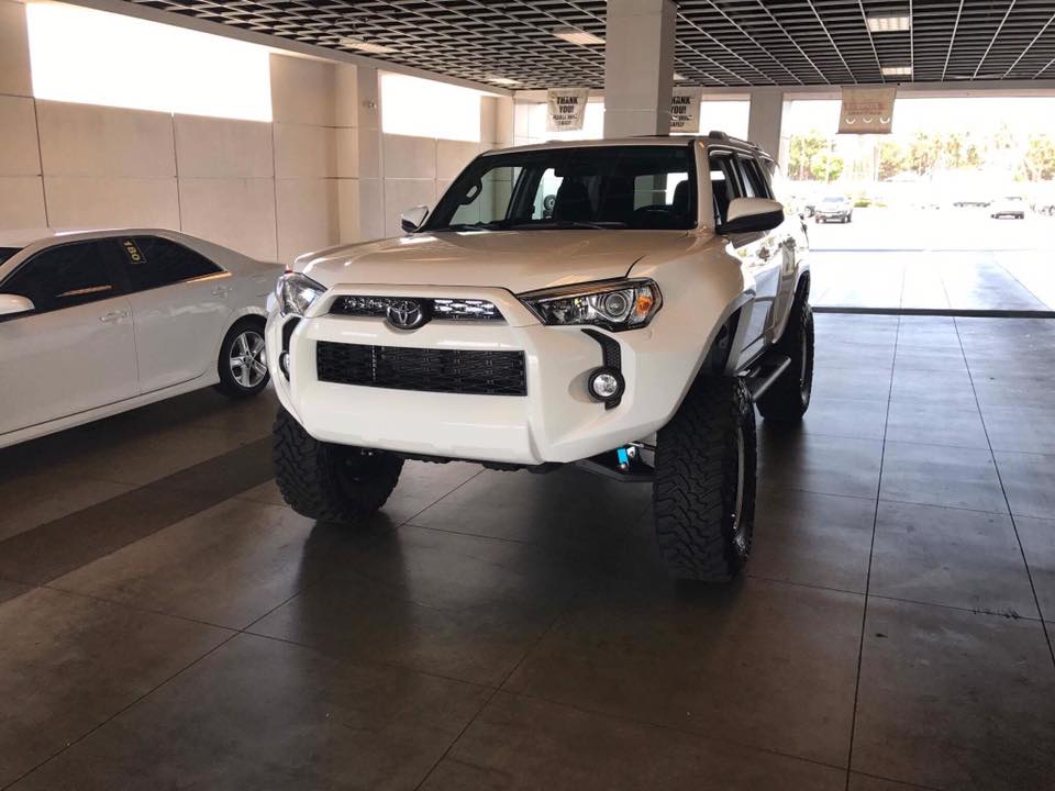

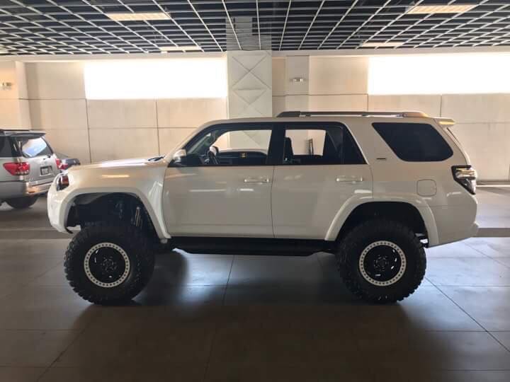

Any idea who truck this is. Spotted in Ontario, CA.

Not a fan of those. Not at all. I'll give Victor's source a lot of credit for retaining the factory look and not bothering to integrate into the factor front end like that, as anyone really using their vehicle is going to have an aftermarket front bumper of some kind.
theres a whole lot of King in that wheel well tho. still waiting on you to run some smoothies through the rear cargo area and cage the back half.:bounce:
The backwards rake says a lot about that build not necessarily being sprung right.
Either way, I like Victor's approach to the flares a lot more than those.
