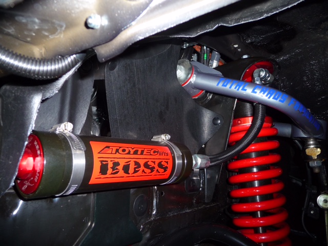

Toytec BOSS at SEMA
Toytec is showing their new remote reservoir on the BOSS 2.5. This one installed on a Taco. Available "soon".
