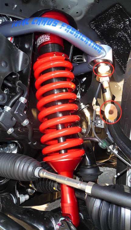

Rust/Flat Spots on Steering Knuckles?
Anyone know what these flat/rusted spots are for on the steering knuckles? Why didn't Toyota paint these at the factory, and should I paint them now?
ToyTec Boss 2.5/Total Chaos installed by the great folks at Rebel Off Road. Highly recommended. (Rebel Off Road).
That bottom one is for standard suspension sway bar linkage.
