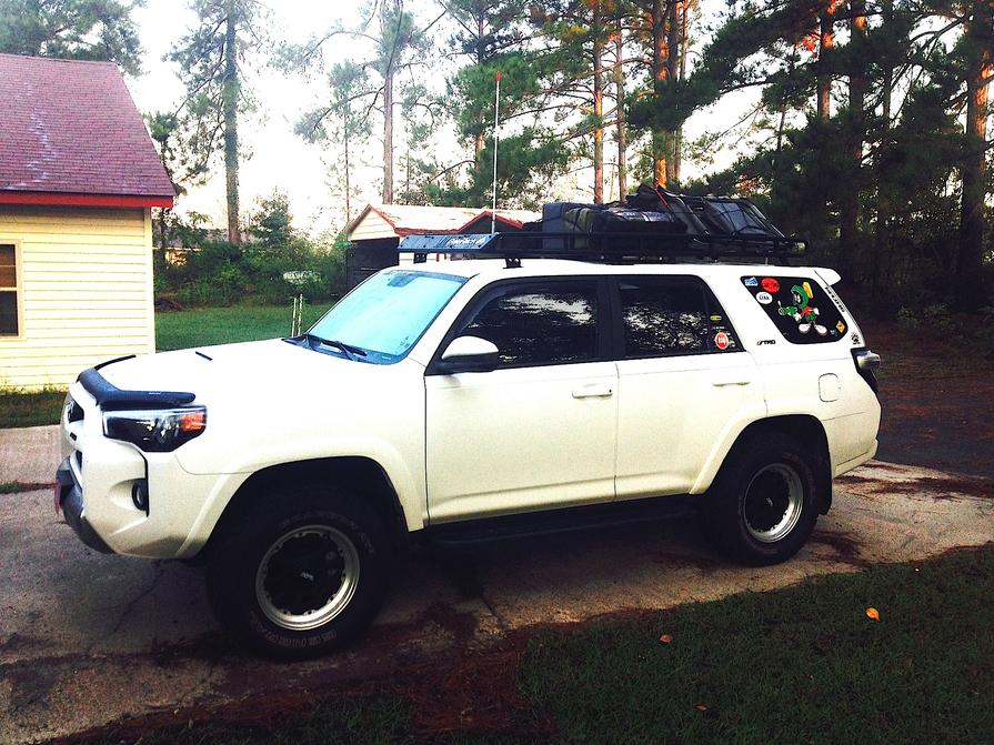

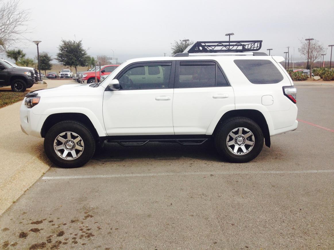

Does anyone know if i installed bilstein 5100s fronts set at 1.75 and replace rear shocks to bilsteins, will this set leveled and if it does when i have passenger's in the back or some etc. In the cargo, how bad will the rear sag? Or should i add a 1" rear spacer ?
You're looking at body leveled with a couple hundred pounds in the back. No "noticeable" sag with 960 lb load on a trip in Oct 14, but the ride was definitely softer and more sedan like. Top pic is the day of the Bilstein installation, Bottom is loaded for that trip.

It will be very close to level. Any weight in back and probably will sag. I did 1.75" 5100s up front with 1" cornfed in back and it has decent rake.
I dont know if its my eye playing tricks but to me it looks like you have reverse rake in both pics.
