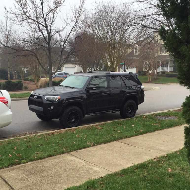

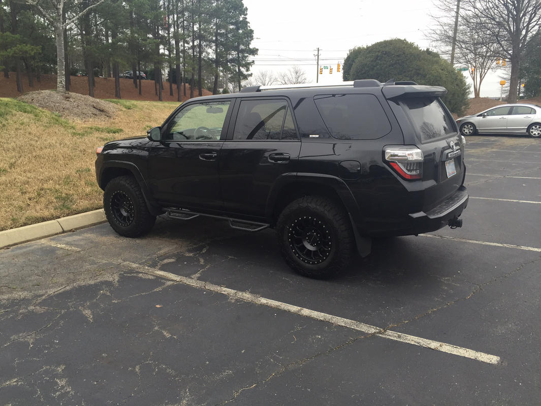

Anyone got pics of there t4r with bilstein 5100s set up, fronts set up at 1.75 and rear 1inch spacers? I just wanted to make sure thats the set up im going with.
I dont know if its my eye playing tricks but to me it looks like you have reverse rake in both pics.
Yes, i see reverse rake in both pics as well.
Yup. You sure do. I said BODY leveled. There is a slight reverse rake in the frame, but the measurements from the ground to the tops of the fenders front and rear is the same with a 1.75 front and 0 rear. And the roofline sits level. But what do I know. I only had it installed, loaded it, and drove it for 10 months like that. My left leg is longer than my right one also. Glad I could be of no help. Again....

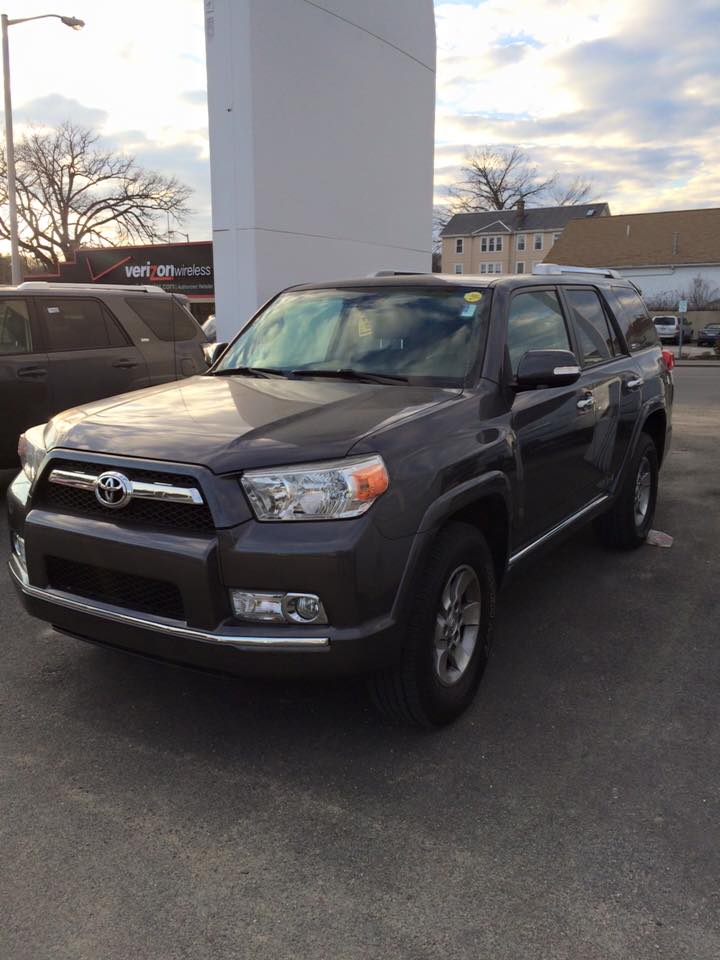

Just picked up a 2010 SR5 and I'm considering a lift but i don't want to upgrade the tire size.
What would be my best option? leveling kit for a higher look? 2.5" spacer kit?

If you want to keep tires the same, just get a some spacers for the front to level it. Or read the stickies even more, read more posts, and next thing you know you'll be like, "How do I fit 35s?"
The more i read the more i think the leveling kit is the way to go. But i also think your right and i will eventually be getting bigger tires. Thanks!

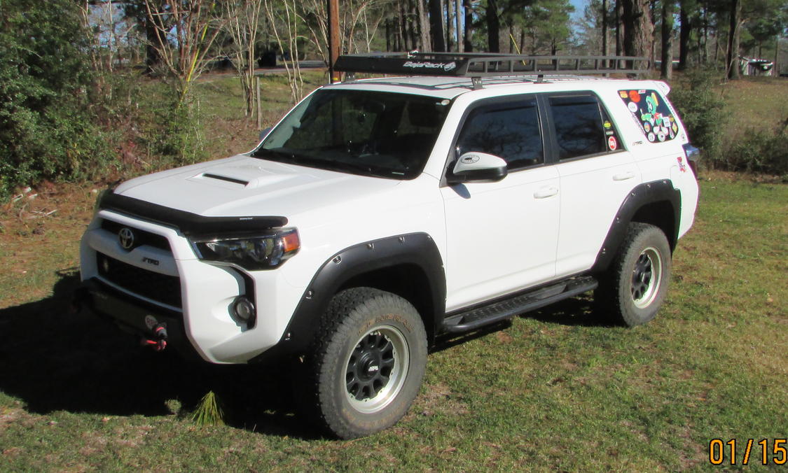

By "inexpensive" i mean about $400 for the Bilsteins and about $80 for the spacer (as I recall) both ordered from Toytec. Set the front Bilsteins to 2.5" and you're almost level with a 1.5" lift on the rear.
