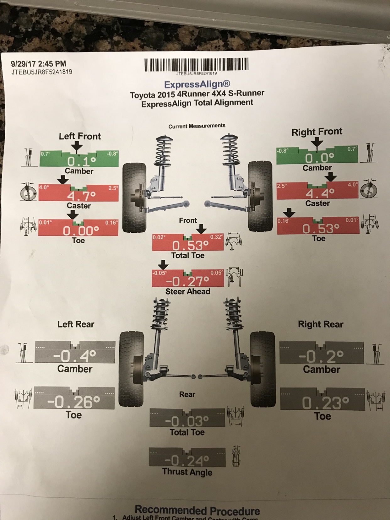

I actually just had a similar situation. 285 ko2s, SPC UCAs at D. I took mine in late so they didn’t have time to complete the work which was annoying but they were able to get my caster to 4.4 and 4.7. They said that I needed to bring it back because they hadn’t gotten the steering wheel straight. They said it had a 5 degree right lean. I didn’t really notice it. When I take it back in Wednesday I am going to have them dial it back to 4 because it is almost a chore to turn at speed. I’m clearing my body mount by at least an inch.

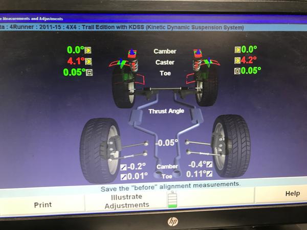

I got everything sorted out today thanks to Justin @ Fastlane Auto in Smyrna. The results are great and I don't rub at full lock anymore. Drives great now. Very pleased. Still disappointing that the first shop charged me for a bad alignment, but I'm happy to be back up and running now.
Here's my new alignment:
