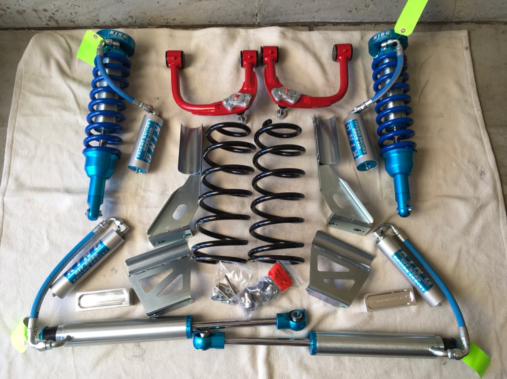

I recently replaced my xreas on my 2011 Limited
I love the setup minus the shitty Icon rear springs.
