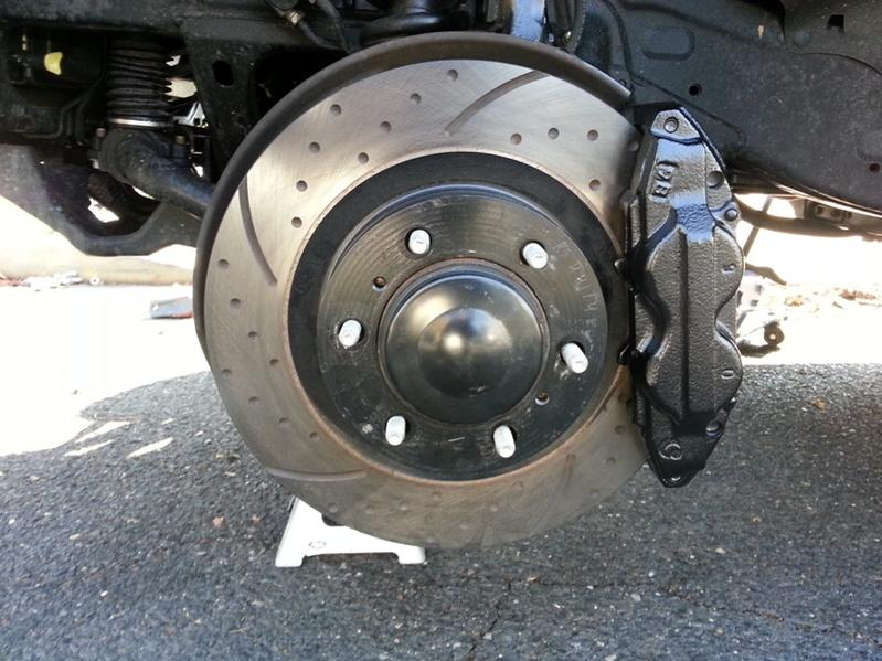

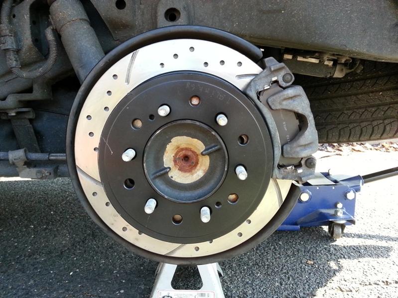

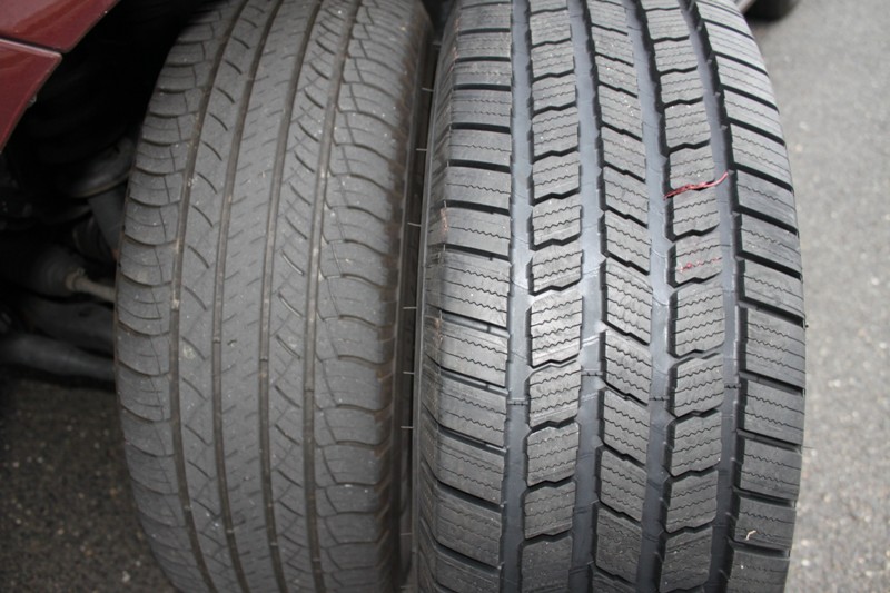

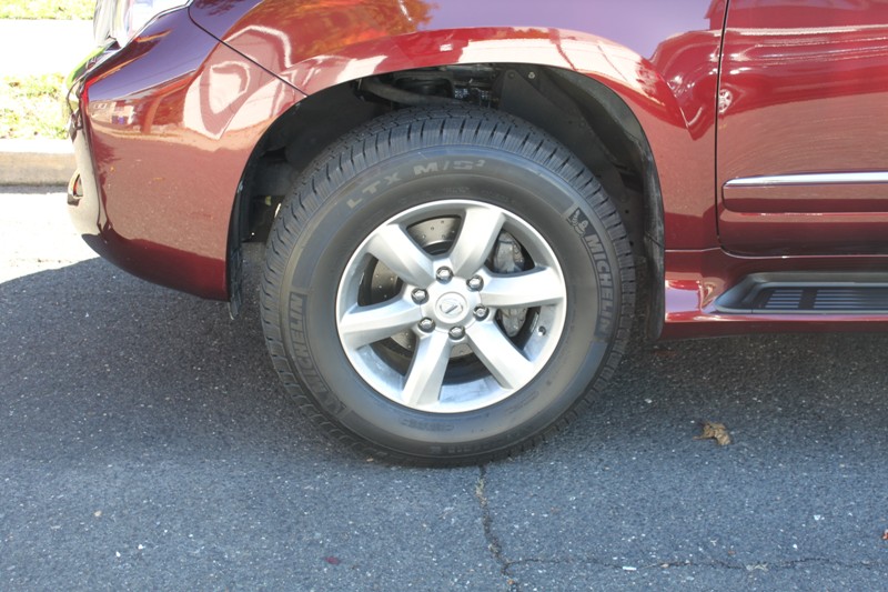

I changed my tires/rotors/pads (on my GX which is 500 lbs heavier) and the brakes feel much better. I first had HP semi-metallic pads and then changed them to ceramic (mostly because of dust) which feels better. The rotors are dimpled and slotted. The LT-LTX MS2 changed the whole ride (much more stable and smoother). The main reason for changing everything was because I have a cross country trip planned for early spring where I will be towing a TT through the Rockies.
