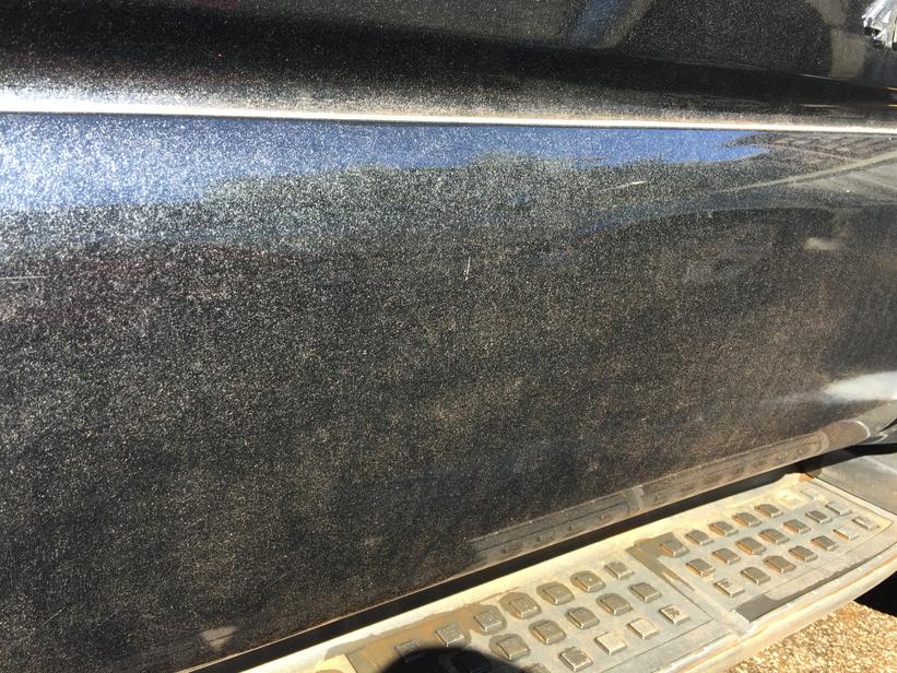

Also does anybody know how to remove brake dust. My front right caliper was down to metal on metal and pretty much ruined the paint
