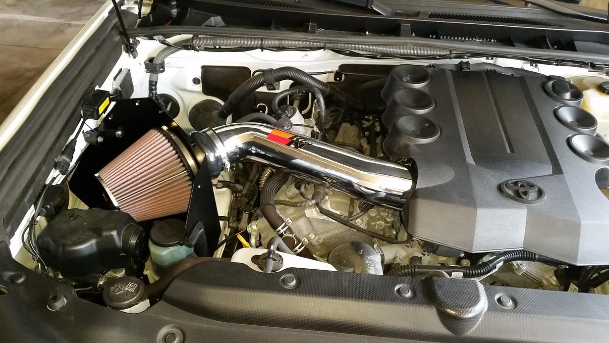

Extremely happy with the growl the K&N cold air intake creates. Can't say anything regarding MPG's (& horsepower) as I haven't noticed any gains over stock. Looks good, sounds killer... If I hadn't got such a good deal on the set-up from friends of friends over at K&N then I don't know if I would have forked over the near $400 for this part?? Hoping the soon to be exhaust upgrade really shows off the intakes performance abilities. Cheers to tax return season :party:
