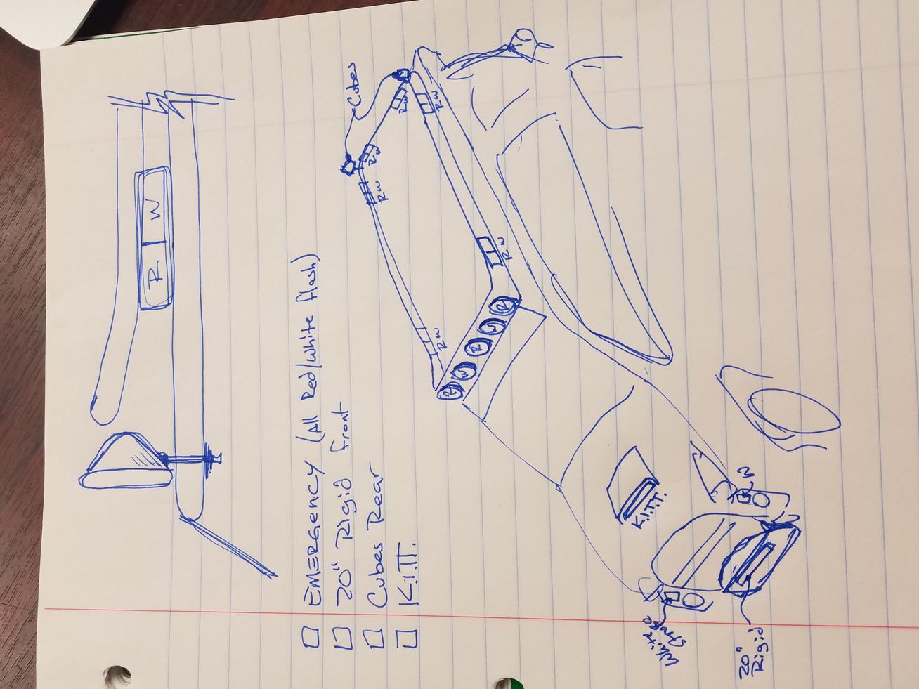

Now that I am a grown-up and awaiting delivery of my 2017 Cement TRD Pro I am trying to decide how to integrate Scene lights, Emergency lights and Trail lights into one solid package.
I do have a GOBI rack that is under production, only six years or so to wait on that to deliver haha, that I plan to place the larger Red and Whites across the front, then run a string of tiny single red/whites between the top and bottom stealth rails to complete the 360 around (not 100% around, but in all directions ya know). I just want to have two simple switches set up, one for emergency with all flashing, and the other for scene lights with only the whites that should illuminate all the way around the truck. I would also not mind tucking some strobes into the otherwise useless hood scoop just for the kid in me to still smile about, maybe even with the KIT car look for those special occasions!

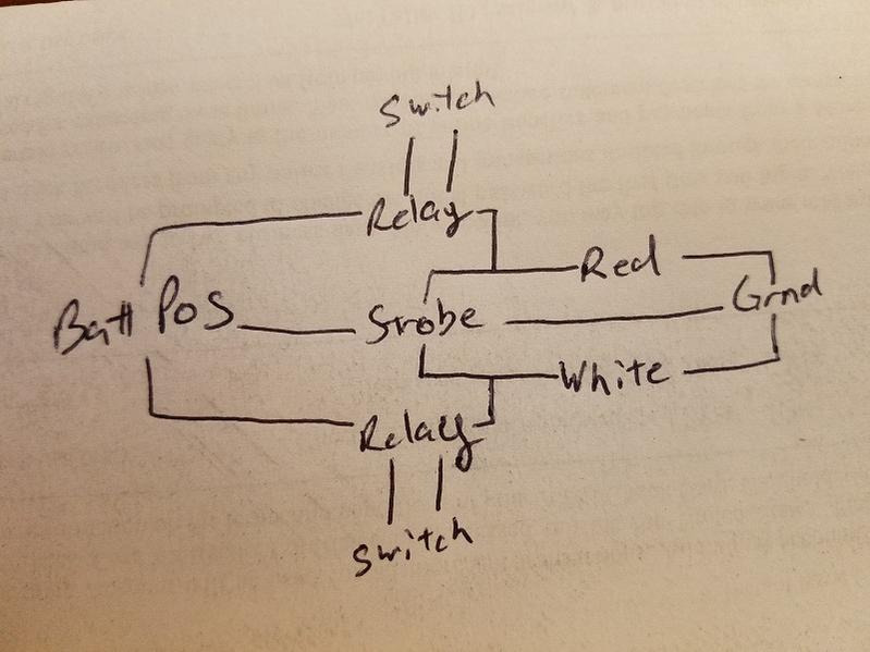

Try this for wiring. Although maybe [MENTION=65614]Antman[/MENTION] can check me on this as he probably understands more wiring than I do.
Wire all your negatives to negative as normal. Wire all your white led positive together, and all your red led positive together. Wire strobe module (Something like this) using one channel for each color. Then tap in a separate positive feed through a relay controlled by a toggle switch to each positive side bypassing the strobe module. This will give you one switch constant on for each white and red, plus the strobe module. Please excuse the poor diagram, I'm certainly no electrical engineer.

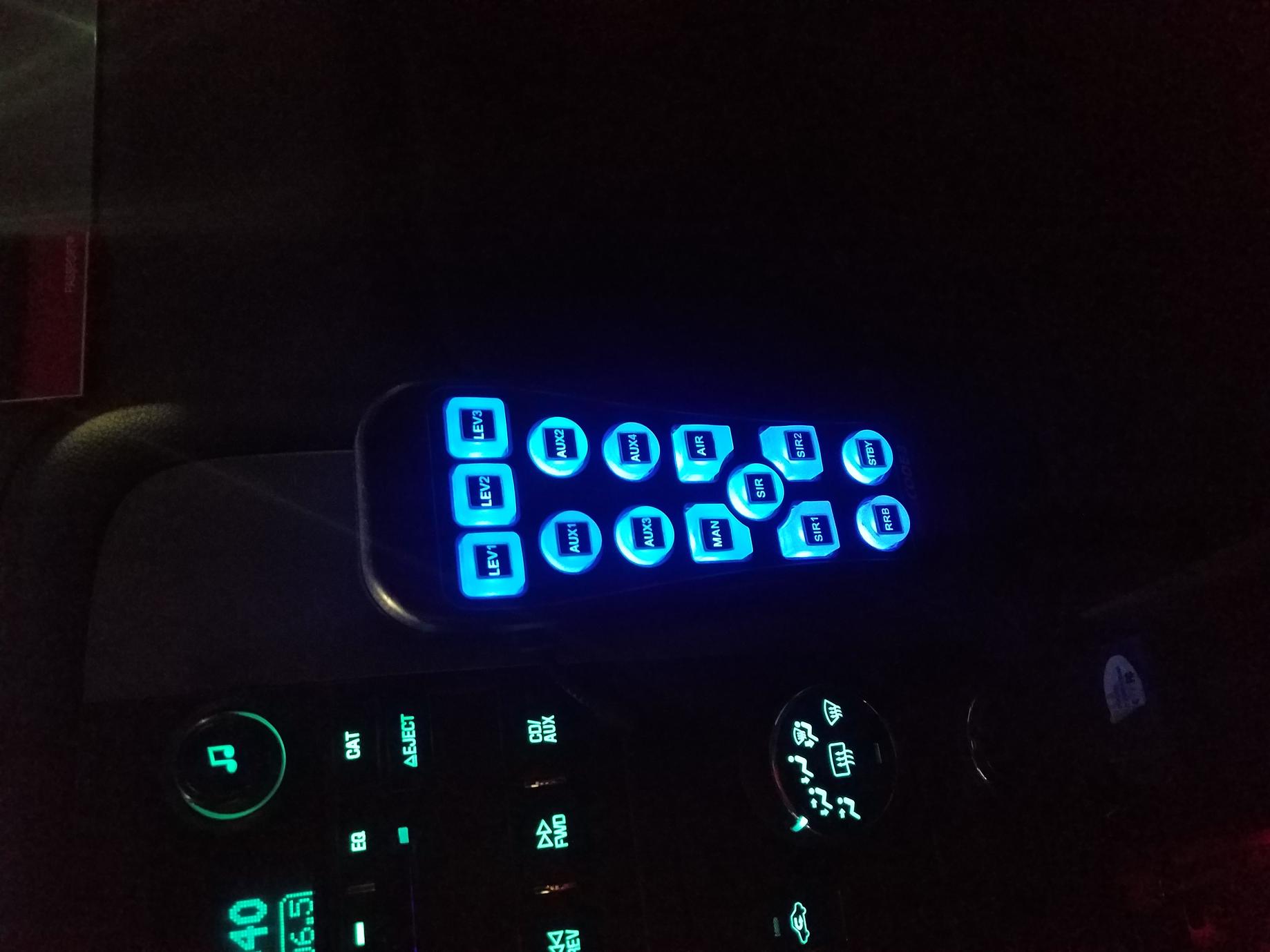

[MENTION=66389]BlackWorksInc[/MENTION] I actually drive one of those Chiefs vehicles, Suburban type, on my full time gig and we have the strobes blocking the window space and the light bar on top all run with a Code 3 handled controller Code 3 PSE H2Covert Hand-Held Siren/Light Controller - 3599L5 from SWPS.com
It is very convenient, and I was leaning that way for the brains of the system but the Switch Pros that a few have mentioned looks real slick, and with a GB discount the price may come down to compare. I will be getting the Specs off the SP-8100 and taking them to my local emergency lighting shop to compare notes against the Code 3.

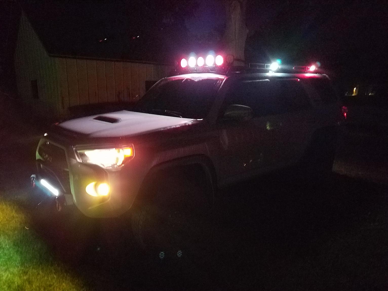

So I stopped in to the local shop today with my lighting plan and based on my wants/needs (yes, I want the KITT lights in the scoop and they said it was cool and I would be cooler for doing it... so that will happen!) the Code 3 Covert system will push it all. At ~$260, and it includes the siren box controls too, it is kind of a no brainer now. Attached is a pic of the controller hanging in our suburban so the mount is not all too obtrusive. Some users don't even mount it and just tuck it into the glove box when not using it. And the schematic sketch.
When the rack arrives I will mount all of the lights and have the wires strung to where the box will be to save on install pricing and just need them to ensure the box is plugged in appropriately so as to not burn it down.
I will post pictures...and video if I can figure that out, when the time comes. thanks for the help so far.
