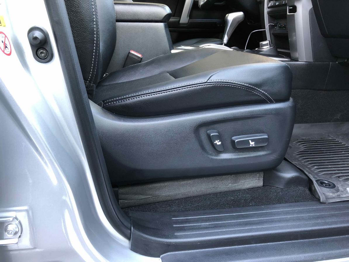

Well this seems to be my culprit! Thank you very much sir.
Granted, likely do not need the entire piece covered (had left over sound deadening material) but I figured do the entire piece and I can always trim it down. The bottom wraps up underneath to put some pressure on it.
Maybe when I upgrade the audio some day and I have to remove the seat I can do a more elegant fix. But for now... just got back from riding around and I do not hear the rattle while hitting bumps.
That is awesome! Congrats! Happy it worked for you. Enjoy the quiet ride.
