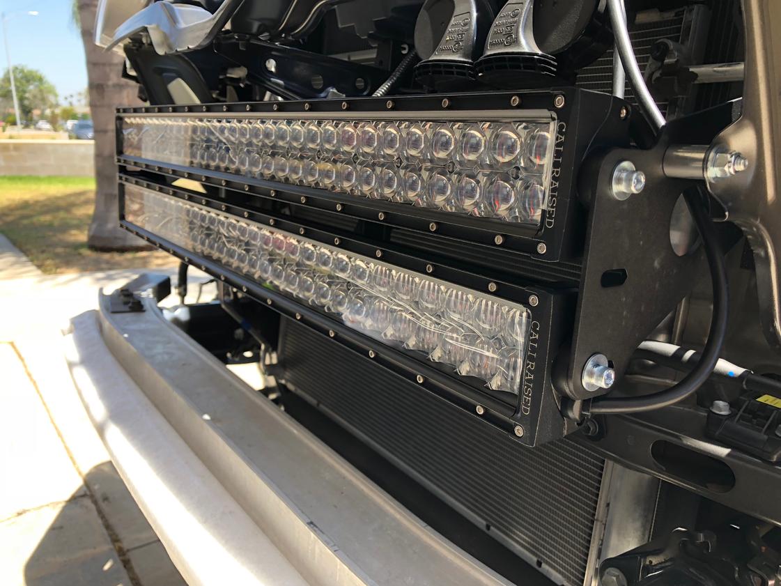

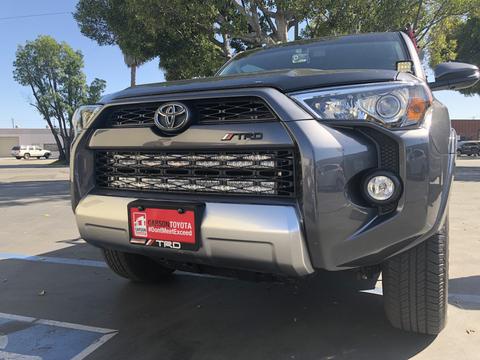

Another happy customer with our 4Runner Bumper set up runing two 32” led bars!
