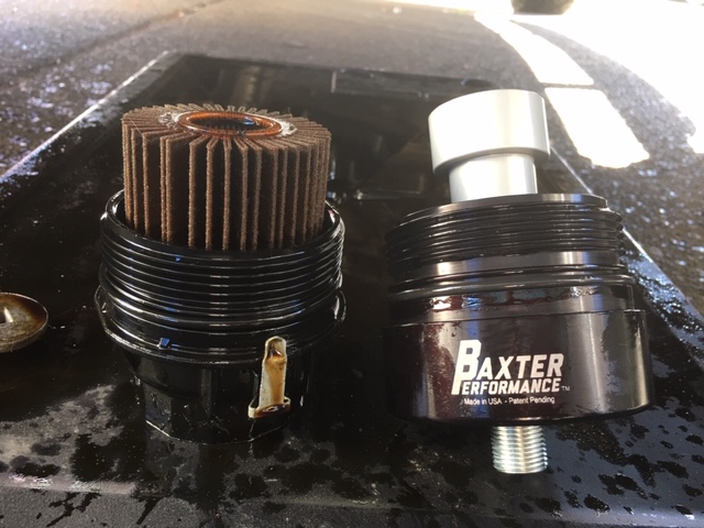

What ever happened to Jowett ?
I know the first batch was messed up,but he made good with the 2nd batch.
Does he not produce the housings anymore ?
The factory plastic oil filter cartridge housing is know to crack thats why they are for sale everywhere to replace them.

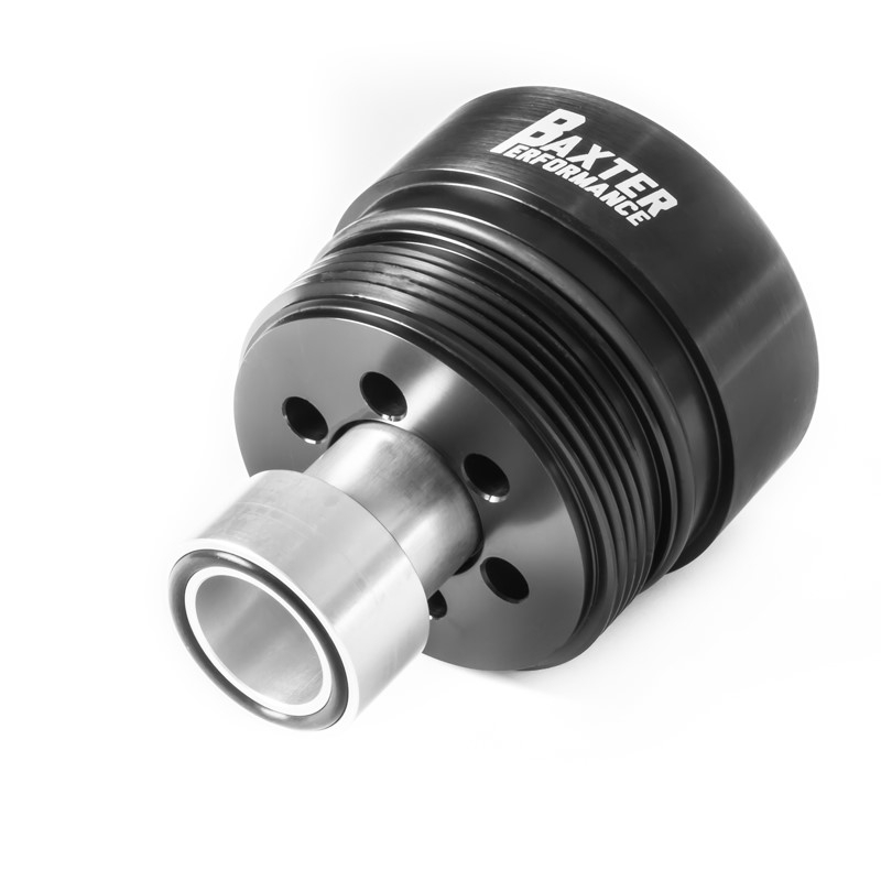

Installing the billet aluminum adpater from Baxter Performance also eliminates that issue of cracked filter housings. So another plus.
baxter performance oil filter adapter for spin on filters.
Cartridge to Spin-On Adapter

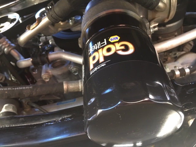

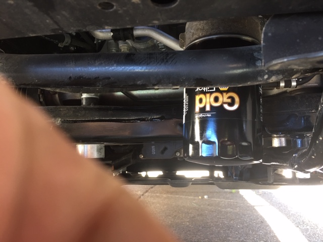

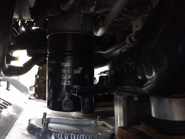

Keep in mind this particular oil filter I used will not clear the factory stamped skid plate without hammering on the skid plate. The TRD skid plate or any aftermarket skid plate clears fine.
You could also just use a shorter filter than I did. Or read my build thread page 8 where I talk about other filter option
Sooo if you bash a rock and dent the skidplate you have the potential to smash that adaptor which hangs way to low now.
Smart indeed. :wink2:
Only with the stock stamped steel skid plate which is crap anyway and most people replace it with aftermarket. You can see with the aftermarket skids I have at least 3 inches of clearance.
And like i said you can use a shorter filter if you are using the stamped skid. The filter Im using is twice as long as the factory cartridge filters for more filtration area

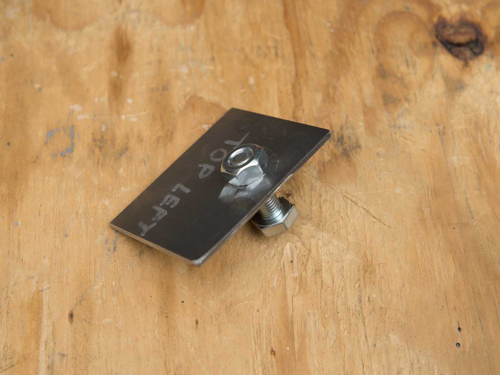

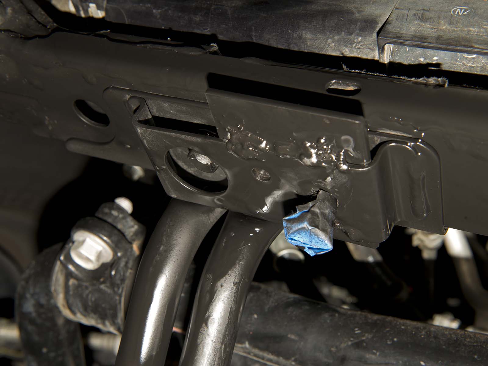

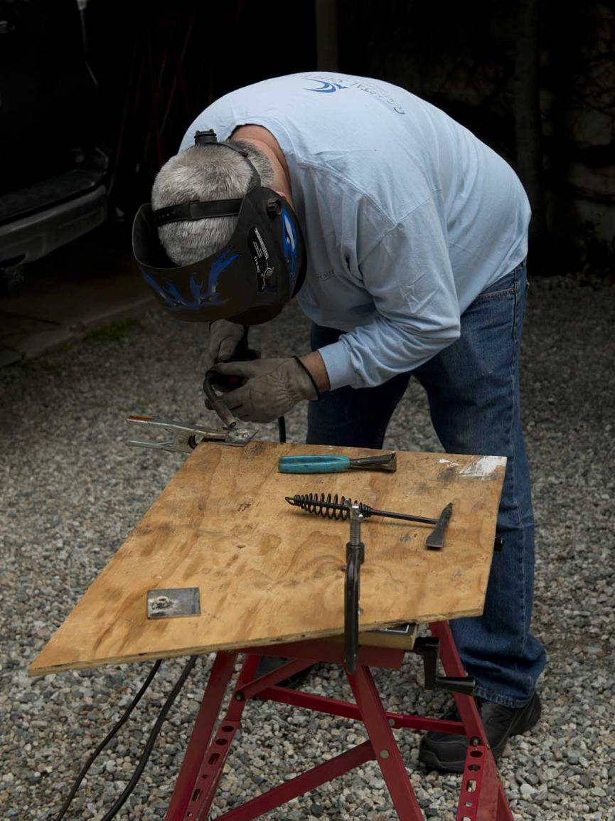

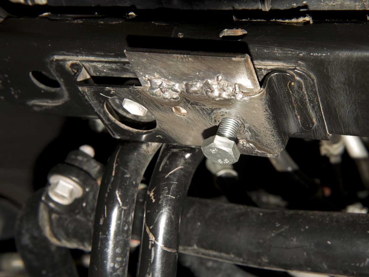

In doing the "FREE" oil change (when the 4Runner was new) at the Toyota dealerships, they often overtighten the 8 mm 1.25 pitch threads, stripping the welded nuts and/or the bolts. In my case, I could not remove the nut. I stripped the bolt heads round trying. I had to cut the skid plate off so I could work on the suspension lift.
To fix the stripped nut, I had to cut off the welded 8 mm nuts from the frame and adapt a new nut with a larger 10 mm, 1.25 pitch.
I cut an 1/8" flat plate to fit over the OEM frame bracket where the old 8 mm nuts were. The plate was made wider than the OEM bracket so it could be welded from below on two sides with an overhead weld. Then I drilled an oversized hole in the OEM Bracket and 1/8" plate at the right place to fit the bolts for my RCI skid plate. The same place as the OEM skids. I welded new nuts onto the 1/8" plate and then welded the plate on top of the OEM frame bracket that supports the OEM nuts. This gave me a stout place to anchor the skid plate with a 10 mm bolt. The 10 mm bolt is less likely to get stripped and offers a stronger connection at the front of the skid plate. Photos of the parts ready for welding, my friend Danny doing the welding, the plate welded to the frame bracket and the plate all over-painter and ready to reinstall the skid plate.

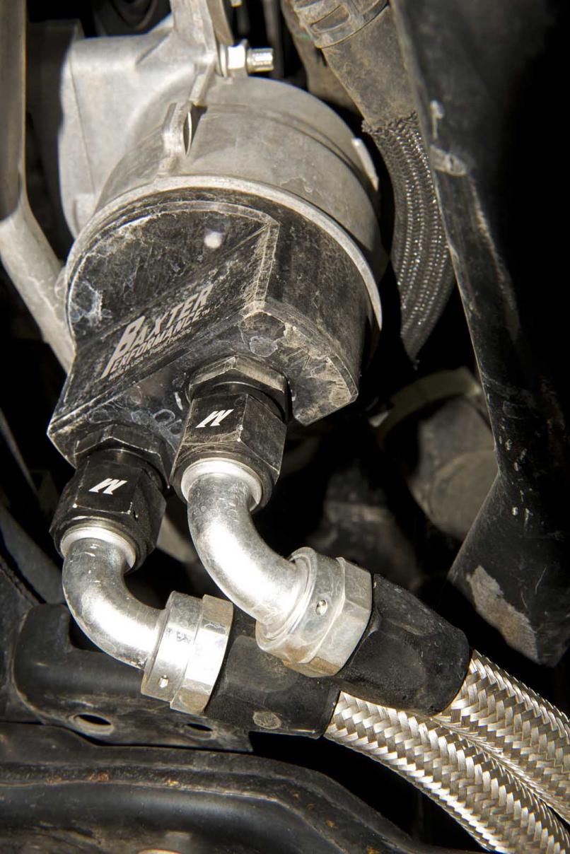

Baxter Performance Remote Oil Filter
Baxter also makes a remote oil filter adapter that allows you to position the filter up higher in the engine bay. I had that system but I knew the weak link was the AN-10 oil lines from the Adapter under the canister location to the filter adapter. If the oil lines leak the only way to repair it is with a new oil line and by replacing the oil. You can make the lines with the right parts or buy one pre-assembled. To make the lines you have to have a vise and hose grips. You can catch the oil and put it back in the engine through a paint filter but that requires a clean oil catch pan, a filter and a funnel. None of this can be done in the field, INMO. If you spring a leak in an oil hose, you're stuck.
I had that system but took it out when I got a leak in one of the lines because it was rubbing against the skid plate. It was a stainless steel braided line too. Luckily it leaked when it was parked in my garage and I saw the oil before driving anywhere. I will probably replace it with the Baxter oil filter adapter made for placing the filter below the engine.
