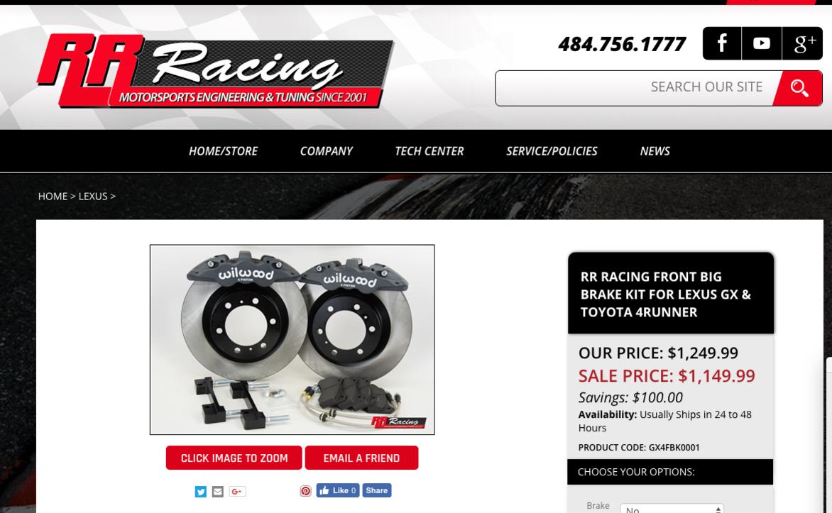

I saw this buried in the 5th gen brake upgrade thread, and thought it deserved its own thread.
Brake Systems
From their site:
After experiencing repeated caliper piston seizure on our shop Lexus GX470, we designed a new brake kit to improve brake performance and reliability. Unfortunately, the original calipers are notorious for experiencing piston seizure due to the fact that caliper is made from cast iron and the pistons are made from steel – materials that easily corrode. Rather than replace with remanufactured auto store calipers (which will typically fail within a year), or expensive new calipers from the dealer, owners of Lexus GX and Toyota 4Runners now have the option of upgrading to our new 6 piston performance brakes.
They state that it uses forged aluminum caliper bodies with six stainless steel pistons, and that this setup is more reliable than the stock setup.
I haven't checked my upgraded 5th gen calipers to see if anything has seized, but if I do find a failure, I'll probably give these a try.
Unfortunately, it seems that they only make a kit for the front calipers, so I'll still have to keep the stock 5th gen (or centric or other brand rebuilds) for the rear.
see:
http://www.toyota-4runner.org/4th-gen-t4rs/196236-5th-gen-calipers-56.html#post2971654
for the T4R.org post that mentioned this kit.
If your 4th gen with accept 5th gen front brakes (in general, I think that means that you have 17" or larger rims), then it should also be able to
accept this big brake kit as an upgrade.

Heh....I'll have to look into this when it's time to do front brakes. My 4R is heavy with all the armor and drawer system. Problem is, with a 6 piston up front and no upgrade in the rear you'll have a LOT of front brake bias. Not as big an issue if you aren't doing track events which I'm sure all of us probably are not doing in our 4R's.
If I saw this before doing my both my front calipers, pads, rotors, and SS braided lines last year, I would have probably bought this... looks nice.
