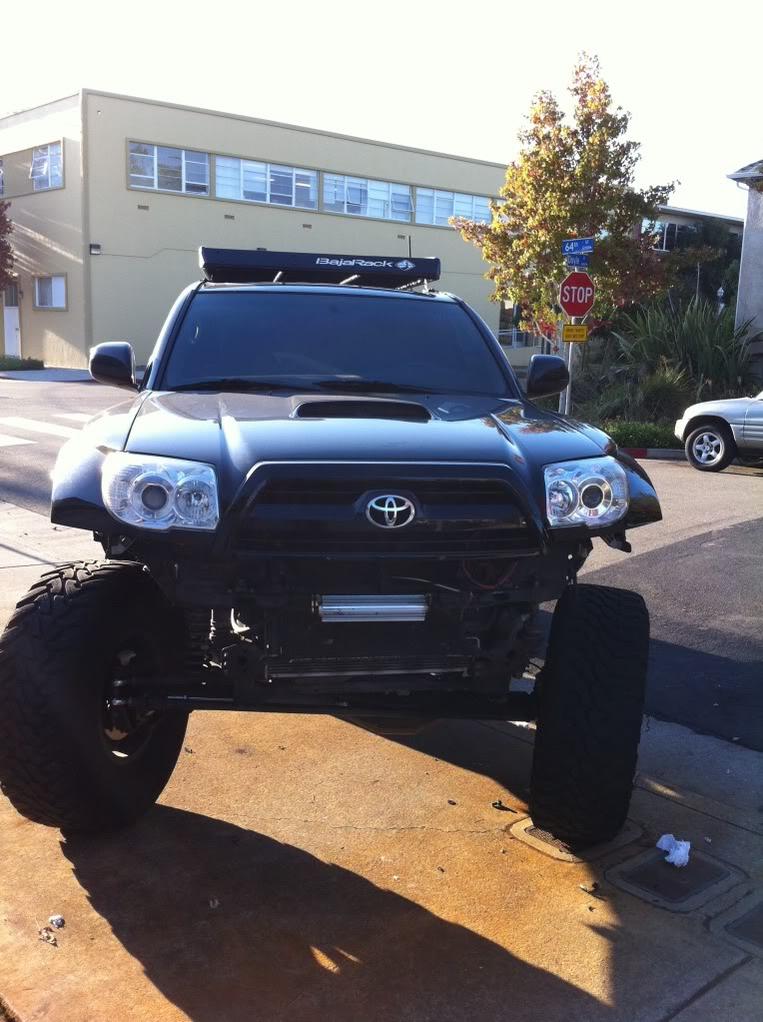

Not to pull people away from one board and drive them to another but Phil did this along time ago....
Phil's Build Thread - Toyota 120 Platforms Forum
He lives right down the street from me now, running a 80 series front axel, Slee high steer and coil overs all around...
Tons of pics of this rig on the Con and Fordyce.
-A
-A
Phil sold me my extended rear sway bar links years ago! :D
His 4Runner is nice, also I have often recommended members visit both forums as T120 tends to be a bit more technical minded and less "what tires fit on my 4Runner."
As for SAS, honestly I think the best over-all compromise for an all-purpose 4WD vehicle is IFS and SRA.
Throw in a 2" long travel front and I think you got a very capable overlanding, crawling, desert blasting rig.
And yes Phil's rig is amazing.
