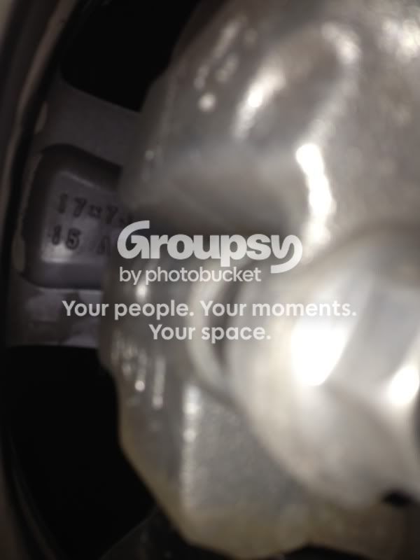

Where did you get those specs ?The wheel width is cast into the wheel on the inside on,on one of the spokes. Yours should read 7J with the 7 being the width and the J being the tire bead profile.
I measured 2010's and I HIGHLY doubt they changed between 2010-2013.I mentioned the year 2010 because that is what I measured and also because 2014 SR5's have new wheels with unknown specs other then they are 17's.
2013 SR5 17x7J stamped on the inside. Sorry, this is the best pic I could get, but I could see it clearly:

Thx Harper. Can't remember off hand where all the info came from, just remember it was from a few different sources. I think there may be some FJ(width) specs mixed in there. Not sure where the 30mm offset came from.

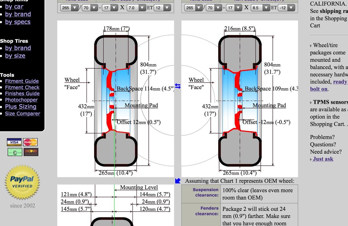

Anyway, I'm looking at a new aftermarket wheel that's 17 x 8.5 with a -12mm offset. by my calculation, going from +12 to -12 is a change of 24mm, and:
24mm = about 1 inch, plus half of the 1.5" increase in wheel width = 1.75 inches total; this should be the amount of distance the outer edge of my new wheel will move outwards in the wheel well. I hope the math is right...
Wheel-Tire Comparer
Have you taken a look at this comparison tool?
If the new wheels truly have a -12mm offset, this seems to indicate you could have some interference problems even if you're still running 265/70's
"Package will stick out 27 mm (1.1'') farther. Make sure that you have enough room under the fender. If not, consider narrower tires or higher offset."
Custom rims, wheel tire packages for your ride - RIMSnTIRES.com
Thanks yes I did find that rims-n-tires sizing tool, that thing is really handy. As for interference, i know its something to keep in mind but looking at the change, i'm not sure what it could interfere with... since it is moving away from the rotor and suspension, i guess the only thing I could possibly get closer to would be the OEM fender flares. but there's so much clearance there already, it doesn't seem like it would be a problem...
Most of the shops you talk to will say "yeah I think it will fit.. or it shouldn't be a problem..." but of course you dont want to go through all the pain of changing wheels & tires to find out how it fits on the vehicle; its like Pelosi saying "we have to pass the bill to find out what's in it" Ha :-)
Those wheels would fit and your calculations are correct!

According to this tool the package ( tire ) will only move out 1" using the same size tire.
BS and Offset move the wheel out, not the width of the rim.

Well... You're correct but to be more specific: going from a stock positive offset to less or in my case, a negative offset will move the wheel out wards from the rotor. However, wheel width is also a factor especially when we found the stock wheel is only 7" wide and I went to an 8.5" wheel, so half of that extra 1.5" adds to the 24mm offset change.
At any rate, I've had the new wheels for many months now and very happy with them. I did have a small amount of rubbing which I fixed by removing the small stock mudflap.

So I believe the outer edge of the rim technically moved outwards 1.7"" total. The BFGs matched the stock size but have a slightly more aggressive tread and of course moving them out creates the illusion they're a little bigger.
wheel: 17 x 8.5 V-Tec Warlord Matte Black
tire: BFG Rugged Terrain 265/70/17
I thought the same until spending some time on this site, it says .9".., they have a point the 265 shouldn't get any wider, but I'm sure it looks it with 8.5"
