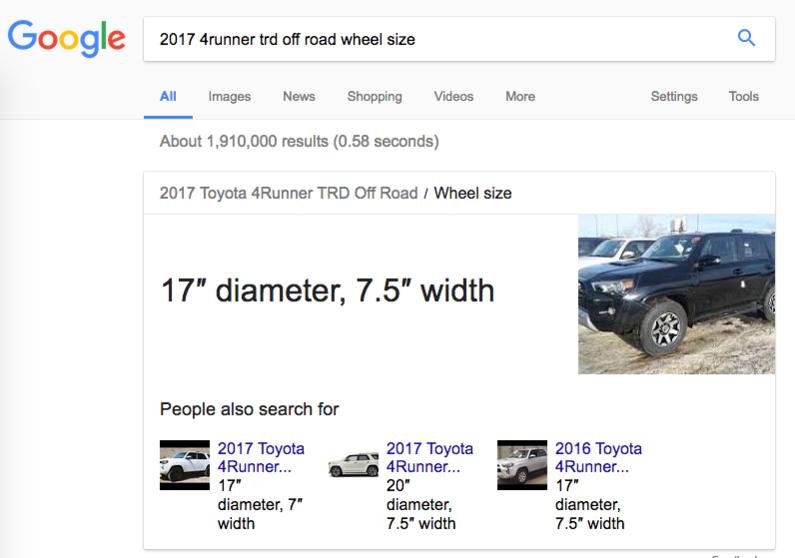

Did you try Google?:
Yes indeed, but I don't trust googles data since it's been wrong too many times for me on other things and prefer a reliable source. Also unfortunately it lacks the offset/backspace info as well.
Well, if you won't trust Google for something as simple as wheel size, who would you trust? Some random guy on the internet, like me?

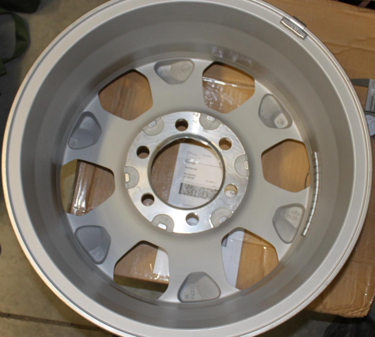

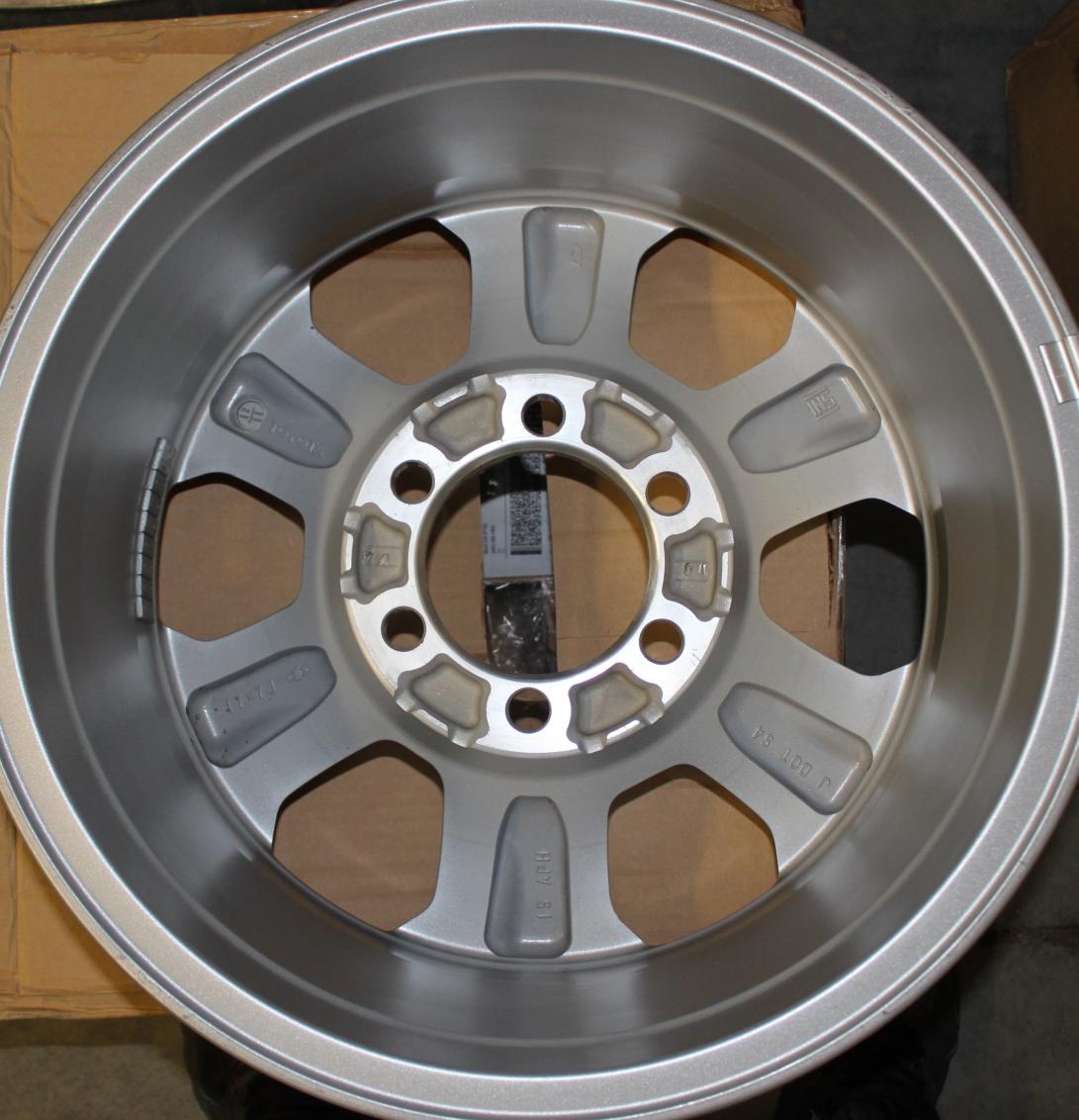

Picked up a set of these apparently hated 'snow-flake' wheels for a set of studs...i think they look like a snow-flake seems perfect for snow tires.
New take offs of a said 2018 SR5 T4R.
One of 4 is different but the same.
Inner casting/machining is different.
Fit and size/Off set and front is the same.
Weird...
