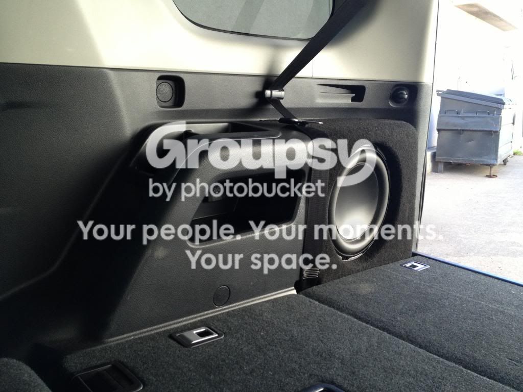

Here are some pics of my custom sub box........ I might be interested in selling it.............

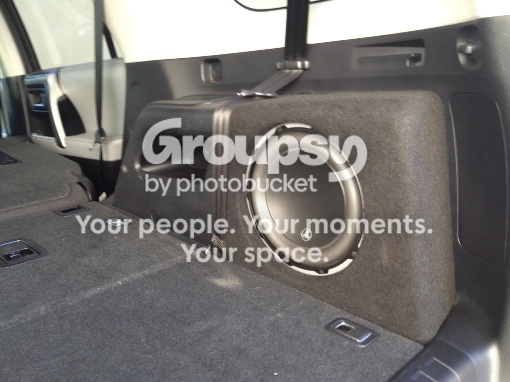

Here is the sub/tool box that i built for mine. Fits behind the third row while still holding all my normal tools and garb. I have turnbuckles securing it to the rings in the floor. I have a 12" in it because it was free. The air space would be better suited for a 10" though.
I have the plans for it in sketchup if you'd be interested in building it yourself.
Hey RG79, that is exactly what I was looking for. Timing sux, though. Just saturday I bought a new JL Microsub, 8 inch. I took my truck to the stereo shop and the guy let me plug it in to hear the difference between that and my current 12 inch pioneer. I honestly couldn't tell the difference.
Are you selling your box and sub? Whats sub is in there now? How much are you looking to get for it? I can't bring the microsub back, but I might be able to sell it.
