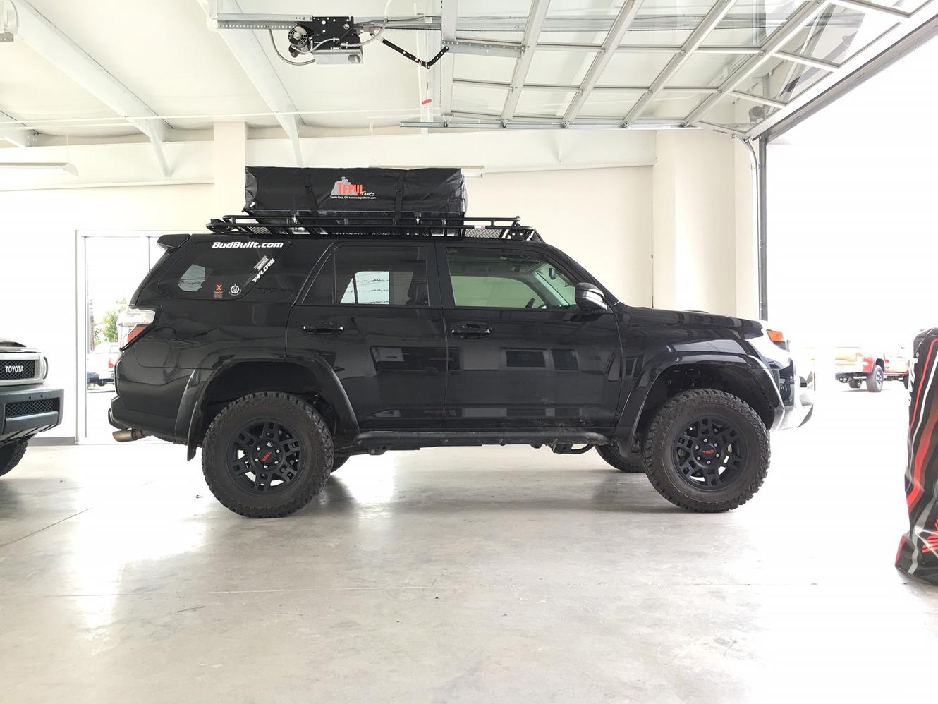

OME is what you seek sir.
I am running a similar setup as you as far as bolt-on's and cargo. We went with the medium springs front and rear, and the ride quality improvement was DRAMATIC. The stock TRD setup starts getting mushy real quick when you ad more than a couple of hundred pounds to the vehicle. The OME setup handles the extra weight so much more gracefully, and improves the stability and handling characteristics of the vehicle. Another plus is you will not have to do maintenance on OME shocks as with some other setups.
OME Kit
Hope this helps.
OME Kit
Hope this helps.
Looks really good, I wish I got the black TRD. So I already made a purchase via Toytech here in Colorado - I went with the below link but we swapped out the springs shown for the Icon overland springs. As soon as CBI can get me in for the bumper I'll post a photo of the whole set up. Toytec lift kit for TRD Pro 4Runners & 2014 Ultimate Edition FJ Cruisers
