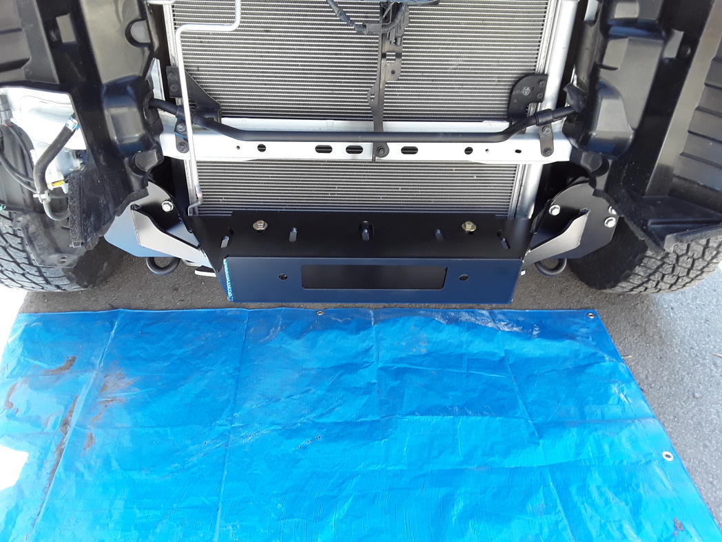

After looking over my Hidden Winch Mount my questions are:
What are the eight 5/8" bolts for? I assume the four 1 1/4" bolts are for bolting the top sliding plate to the base plate but don't see where the 8 stubby bolts go.
What are the hex spacers for?

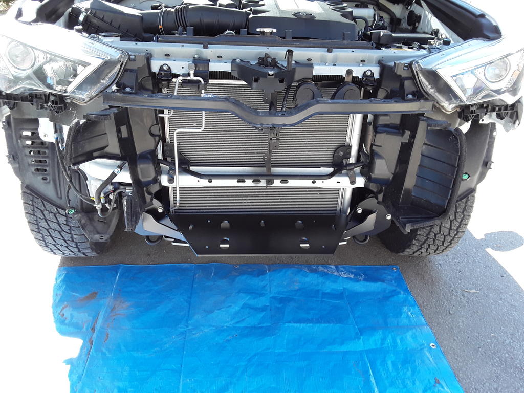

What are these slots for? See pic below.

The 8 bolts are designed to secure the Hidden Winch Mount to the factory frame mounting points.
Ok, I didn't think of that because I've had my bumper off before and if I recall correctly the OEM bolts were much longer. I see you have provided grade 8 bolts which I assume are stronger than the OEM. I guess I'll see when I pull the front off again. Thanks.
Got a call from Michael at Pelfrey today who told me the 5/8" bolts are for other trims to retain the factory splash guards or front plate?! The OEM bolts are to be reused to bolt the mount to the frame rails. I appreciate you guys getting back to me.

You just had me scratching my head there for a bit. Maybe add a page to the instructions showing a pic of each piece of hardware and purpose. I should be putting it on soon. Hopefully smooth sailing from here.

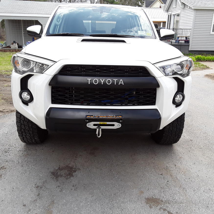

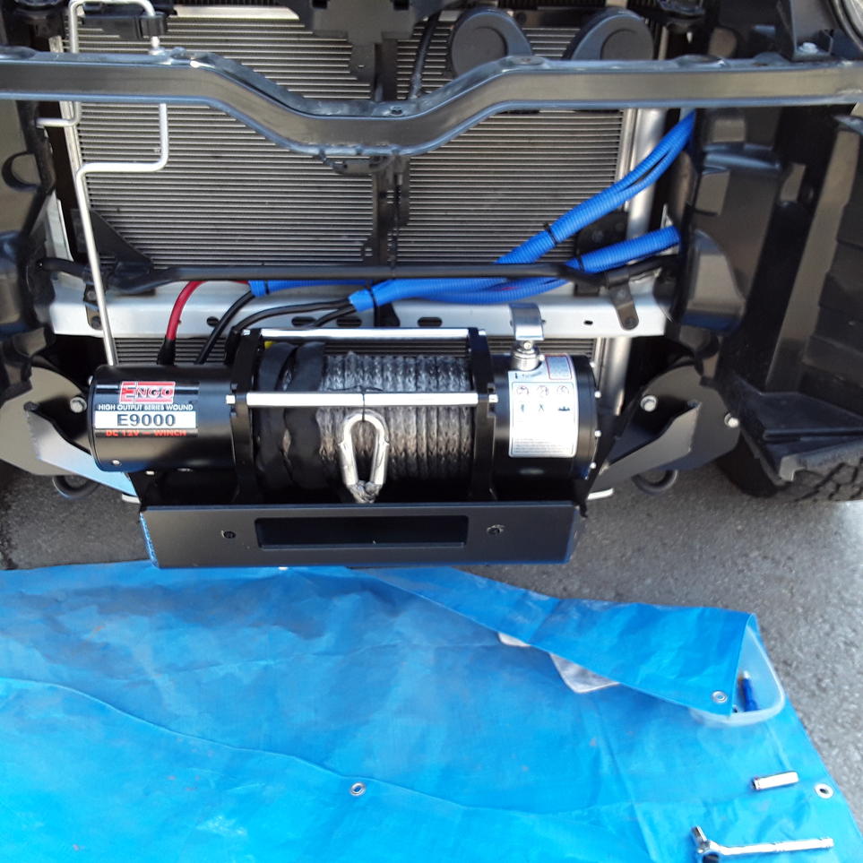

Install complete. Worked out very well. Those aluminum spacers and stubby bolts came in handy. lol
