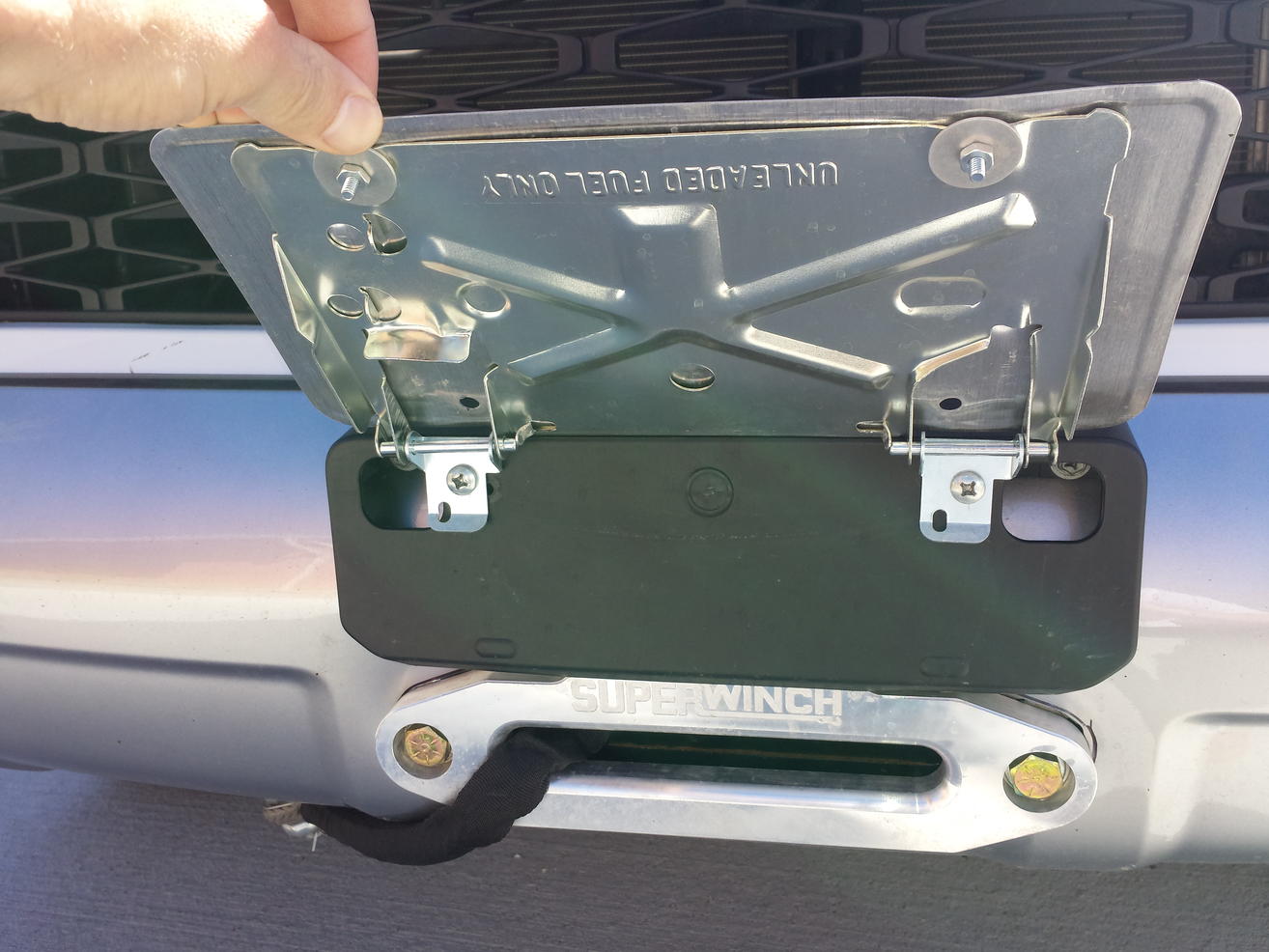

I have a little flip up license plate bracket you can buy on Amazon for $15 and then it's almost entirely hidden until you need it.
151556d1427756512-2015-tep-hidden-winch-build-install-img_20150329_110140-jpg
