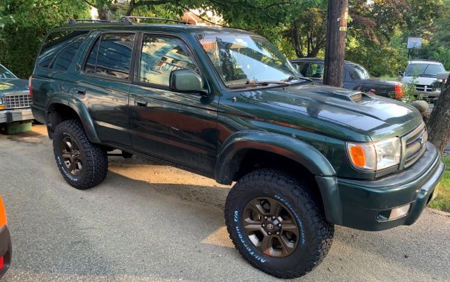

Here's my 3rd gen on 5th gen trail edition wheels.

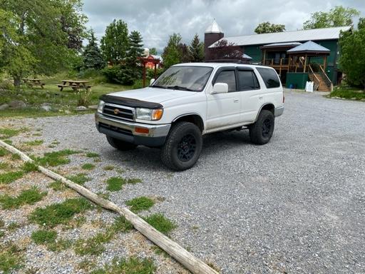

I have some of these wheels that I plan on putting on when I get new tires. Love how they look with the black!
Black 1996 4Runner - 5 speed - 4x4

Yes, and they look good, too.

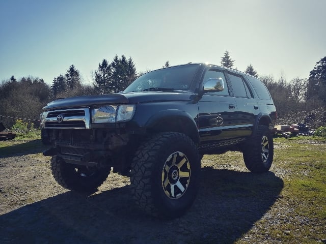

5th gen wheels definitely fit, though I found with my 3" lift, and 285/70 tires I had to install a 1.25" spacer on the front to (mostly) avoid rubbing.
