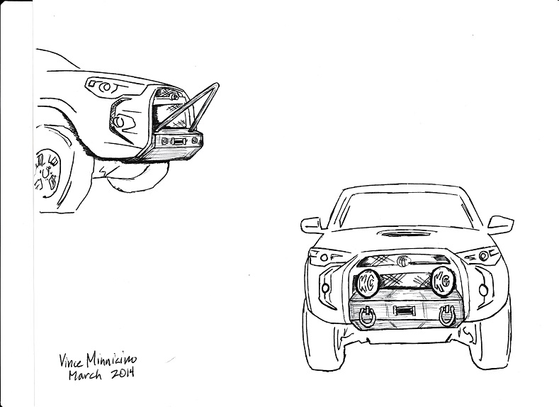

I drew this up last week after looking into winch bumper ideas for my 2014 te. I guess its a hybrid of some sort. I love the stock look and think this still adds protection to the front of the truck without adding 150lbs of steel. Planning of making this myself This summer. I need to plan this out really well and get some of your thoughts before I start cutting up my front bumper.
Thoughts?
Thoughts?
With all due respect, I for one don't care for the 2014 front end refresh, but somehow your drawing speaks to me. Very impressive. :thumb3:
Thoughts?
I like your idea. I've been thinking along the same lines. Something to replace the lower faux skid plate with a real skid plate/bull bar/winch mount. I'd like to leave the rest of the nose alone of possible. I like the way they rounded the lower corners to give good lateral ground clearance and I don't necessarily want a full ARB or Shrockworks type bumper.
I really like the look of the hybrid bumper Toy2G has, but the sides on it just look incomplete to me. No gig on him and it looks completely functional. I just think I'd be happy with just that center section. Especially if it could be tied in fairly seamlessly to replace the 2014 lower center skid plate piece.
http://www.toyota-4runner.org/5th-gen-t4rs/134918-toy2g-build-thread-start-02-07-13-a.html
Thanks guys. This is just a simple idea that was on my mind for a while. I'm not gonna have a chance to take off my bumper and take a better look till I get in my new garage this summer. I'm renting an apartment right now and my tools are in storage. I know it best in approach angle but its protection and I think compliments the truck.
As for that tube/baja hybrid bumper on toy2g
Top half= TITS
bottom half= something is missing
I don't like seeing through those tubes and looking at all that inner fender stuff. But the way it sits above and out is awesome!
I'll go ahead and place my order now, with stinger bare metal. Price shipped to NC? Lol! How about some mounting tabs for a light bar between the stinger?
USOffroad.........where are you? This is exactly what this guy was inquiring about producing for 5th gens. He took requests to gain a consensus on what most wanted for features, acquired the schematics for designing the mounts, and now the it looks like the demand for such a product is rising rapidly. If you guys can get a look at the version he made for Tacoma center sections you"d be most impressed. Someone here know this guy, and if I remember he was applying for vendor status with the board
