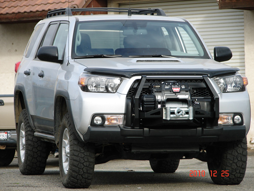

I came across this website wintermotorsports.com and they have, what seems to be, and interesting option similar to ones on the FJ. Does anyone know this company and based on what I have seen on the forum here I don't understand how this could attach and be solid.

I really like the look just want to talk to somebody that has it. Seattlemike. when you took off your bumper did you see anything that you could attach a mount like this to and have it be solid?
It's a great concept just need more info.
Awesome setup, wonder who owns that TE? On a side note, that 4Runner needs a leveling kit something fierce.......Huge drop in the nose height.

Based on what I know is behind the front plastic, they either mounted it to the front aluminum bumper, or maybe they fabricated some mounting plate and attached it to the frame on either side of the radiator. They claim this a "bolt-on" but there just isn't much back there to bolt into and still handle the weight of the truck. That aluminum bumper is designed to crush, you know?
Here's a bad cell pic. I wish I had taken more from better angles.
i think it looks great but still wondering about the bolt on, will it be strong enough, i do like a lot their light bar i think i might go with that

Those products look good and they have some good welds on them, but damn is their stuff expensive. 900 bucks for that winch mount is crazy given you could get a full quality bumper for not much more.

SeattleMike, that's what I thought looking at your pics but looking at a pic makes it hard to be sure. It will be interesting to see how they tie into the frame, or if not how it will be able to withstand the forces.
TOYSTRY, I wonder if it's just the angle of the picture as a winch and the setup holding it shouldn't cause that much of a nose dip. If it does that would mean one soft suspension and I doubt that is the case.

I'm really liking this setup. From the pictures it makes the 4R look very clean. I think the maker has a Ramona, CA address if thats the case i'll be fishing in that area next weekend. I would love to stop by his shop and have a chat with him. I'm gonna try and get some info when i get a chance!
IMO .... I don't know...It would be functionable but it takes away from "the look" of the 5th Gen front end that I've grown to like so much.
I still think this guy http://www.toyota-4runner.org/5th-gen-t4rs/76012-finally-got-tired-waiting-winch-mount.html had the right idea that needs minor tweeking and we need to find a fabricator to make us a internal steel bumper that ties into the frame rails to mount a winch on.The bottom grill opening is the exact height of a roller fairlead. Don't ask me how I know!
The front bumper plastic is so big and bloated already you could carry 2 or 3 bodies back behind the grills.You could easily fit a winch behind it. The only line in the way is the transmission cooler line running across and it has rubber hose ends and could easily be relocated up out of the way.

Personally I think "the look" is retained VERY well. The tops of the mount that are angled in align perfectly with the grill lines. I can't imagine an exposed winch setup looking any better. Inside the bumper is another story though.
I agree. I think that the lines match up perfectly with both the top part of the grill that angles in and the actual location of the winch matches up nicely with the lower block section of the TE bumper.

For what its worth, I feel the unit as pictured looks great. But the best part is that the winch in the mount is one of Warn's Powerplant models with the built-in compressor unit. Good luck stuffing that in the bumper fascia and actually being able to use it.
StuB, hopefully they will call you back with the details. I agree, that Warn winch looks very nice in the mount. Makes me think I should give up my M9000 for the addition of air...especially since I won't have the ARM compressor anymore when I switch to the T4R. I'm excited to hear what they tell you!
