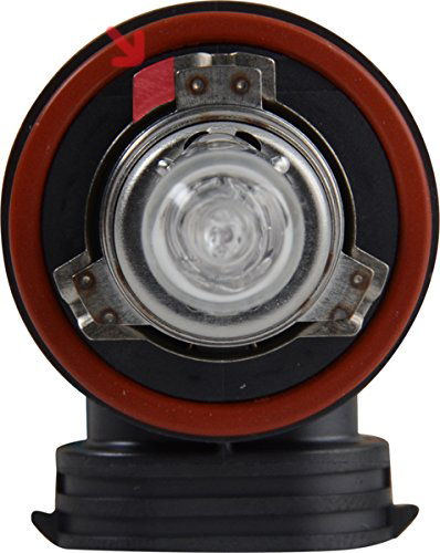

Just get a $3.00 Edit: $7.00 H9 Halogen, trim one of the tabs and hello bright! I'm still not sold on LED lights for headlamps. They are bright, but the money just doesn't justify it for me when I can spend that on something more useful. Just adjust the headlight housing down about 4 turns to not completely blind everyone in your path. I even put them in my fogs. I drove home in a snowstorm with these for the first time last night, and they performed amazing. I have HID's in my 2016 Mustang GT, and a $900 LED kit in my Durango RT. These perform nearly as well as those.

I photoshopped the bulb really quick to show what you remove. The red highlighted area is what you trim off.

Just get a $3.00 H9 Halogen, trim one of the tabs and hello bright! I'm still not sold on LED lights for headlamps. They are bright, but the money just doesn't justify it for me when I can spend that on something more useful. Just adjust the headlight housing down about 4 turns to not completely blind everyone in your path. I even put them in my fogs. I drove home in a snowstorm with these for the first time last night, and they performed amazing. I have HID's in my 2016 Mustang GT, and a $900 LED kit in my Durango RT. These perform nearly as well as those.

Cheapest/easiest is going to be converting some H9 bulbs as outlined above, involves trimming a tab on each bulb so they fit in the socket, wiring plugs right in, takes about 5 min. total time. The Phillips made in Germany bulbs are best, Rock Auto sells Wagner (rebranded Phillips) for around $7 each.
