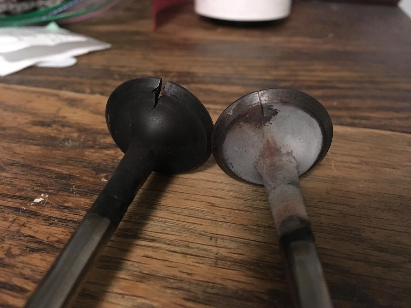

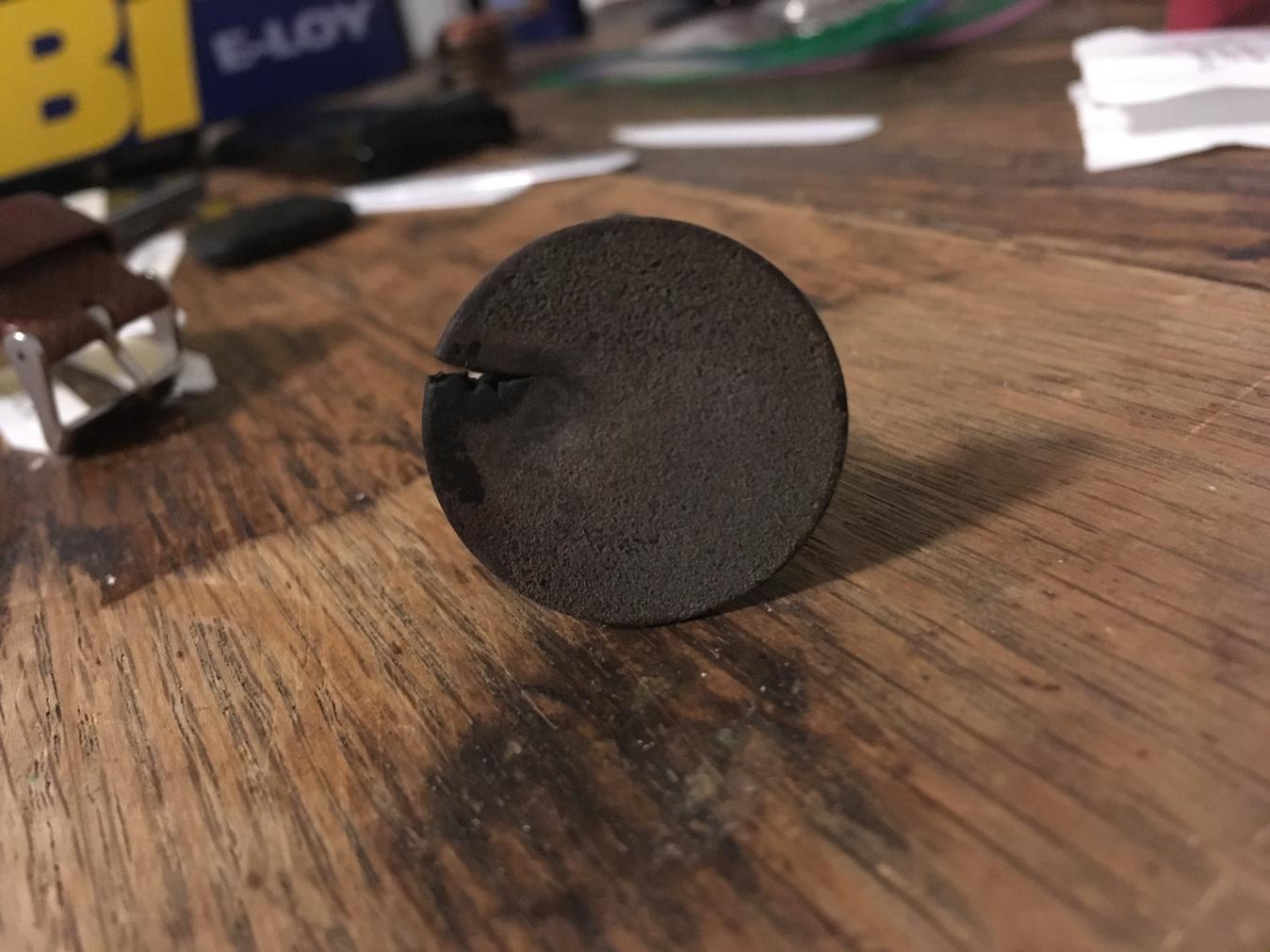

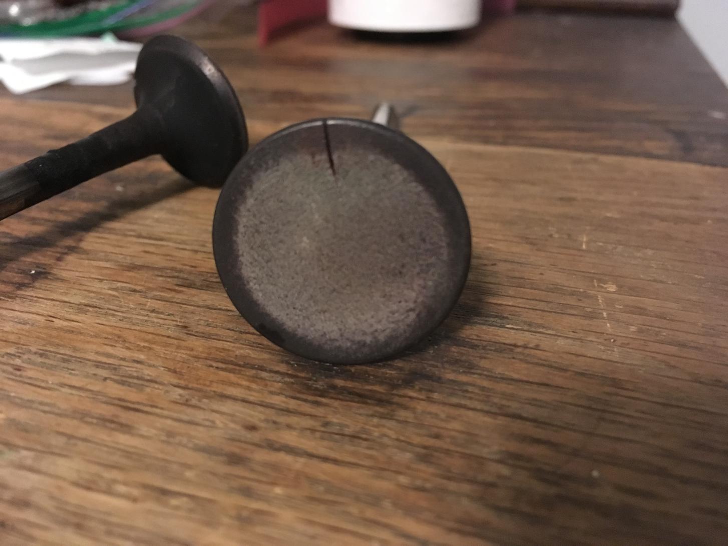

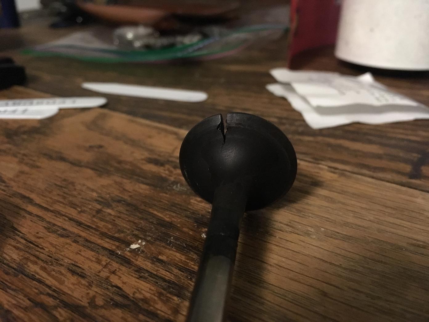

Exhaust Valve Pics
Thank you to each of you for responding. After talking with family and my fiancé, I decided to do the work. I ended up getting a valve job done on cyl 4 and cyl 3, a timing belt & water pump (had 84k miles on it, figured while I was down there), head gasket set, head bolts replaced. While that'll be something I pay off over time, I sure am glad to have it done.
And, now I have an excuse to keep the ol' girl for the next 200k miles at least! :cheers:
Anyhow I thought I'd share the photos of the exhaust valves just for everyone's interest. The larger crack is #4's exhaust valve, the other is #3. Apologies for big photos!
