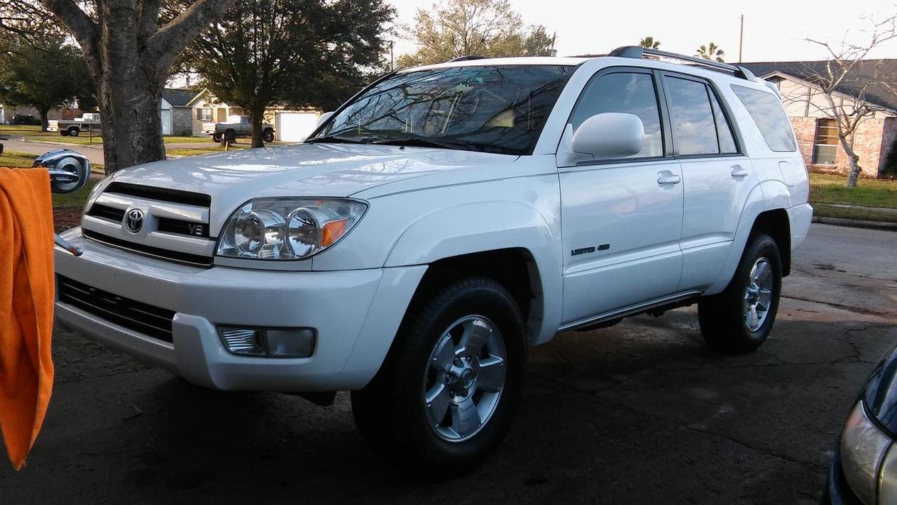

Purchased a 2005 Limited v8 4x4 with 133k miles.
Current mileage - 161k.
Engine/Performance:
Thrush welded muffler
Resonator delete
Deckplate mod
Suspension:
Daystar spacer lift
Exterior:
Painted grill, valance, emblems
Debadged
Homemade fold down tire carrier (Removed)
Smittybilt awning
Land cruiser eBay snorkel
Rola roof rack with extension
Homemade roof rack wind fairing
Interior:
Scanguage 2
Kicker 8" sub
JVC single din headunit
"OH SHIT" handles wrapped in 550 cord
Lighting/Electrical:
Blue sea systems 12 terminal fuse block
Ebay led cannons on roof
Rear back up lights on roof
AutoZone Type-s Bluetooth lights on grille
Amazon led's under dash and back seats
Armor:
Homemade skidplate
Curt front receiver hitch
Homemade front bumper
Wheels/Tires:
265/70/17 Falken Wildpeaks
Stock 17's painted black
Spidertrax wheel spacers
Tools/Recovery:
Smitty bilt shackle receivers front and rear
Wheelers Offroad 20' snatch strap
Mv50 air compressor
Basic tool/first aid kit
Boar offroad traction boards
Pelican all weather gun case on roof rack to store it all
Most current:

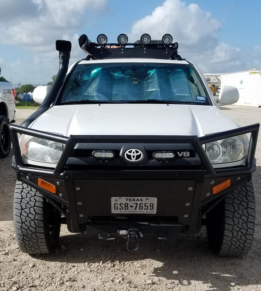

Figured I would update this, forgot I even made a build thread on it.

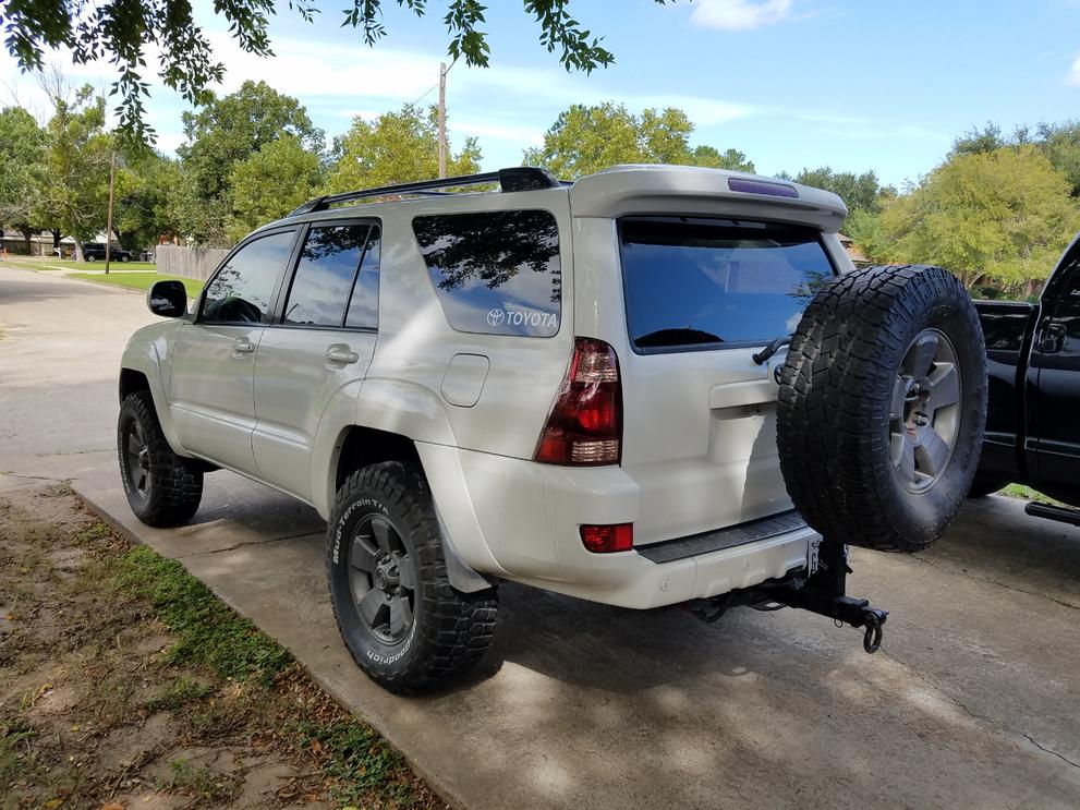

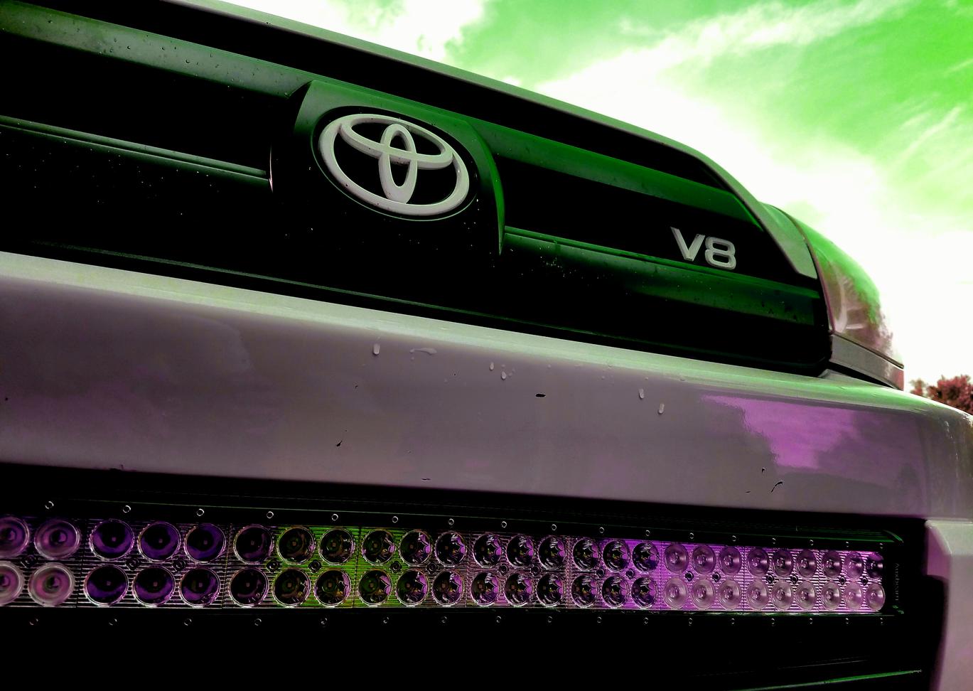

So far (temporary) Daystar lift, 285/70/17 BFG mud terrain, spidertrax spacers, painted stock wheels gunmetal grey, thrush muffler, 30" led bar and painted a bunch of stuff black.

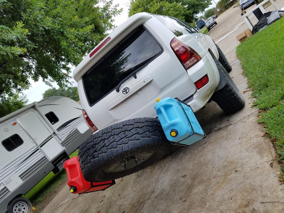

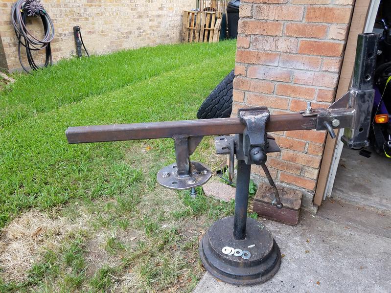

Got the tire carrier done, total cost for everything including bolts and paint, under $150. Took about a week total only getting a few hours a day after work to work on it.

Looks great. Painted details and grey wheels are very tasteful.
Did you have to do any major trimming to get the 285s to fit? Looks like you took the mud-flaps off, anything else?

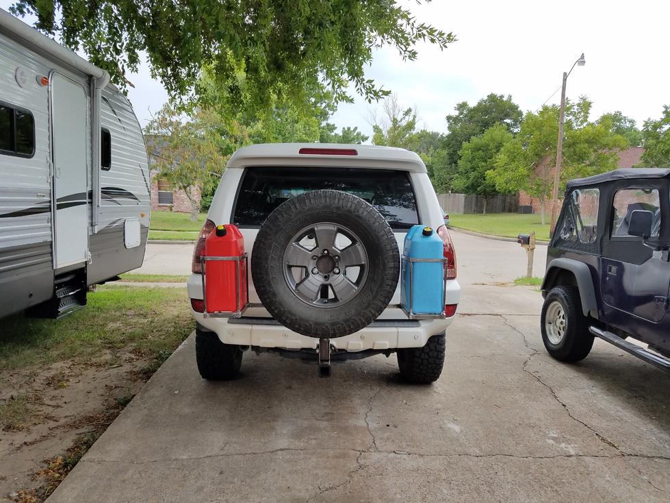

Any details on the tire carrier parts and construction? OR links to others that you drew some design cues from? I know there was some other fold downs on here but I'm struggling to find them. I would like to make a fold down hitch mounted carrier as well, not wanting to go with a full rear bumper and also not wanting to spend $700 for the wilco hitch mounted swing out, with the ability to remove the whole thing if I don't want it for the day.
Thank you. I had to trim a small amount off the fenders, and I pushed the fender liner forward. I still rub slightly on bumps while turning. And I only trimmed the mud flaps, didn't remove.

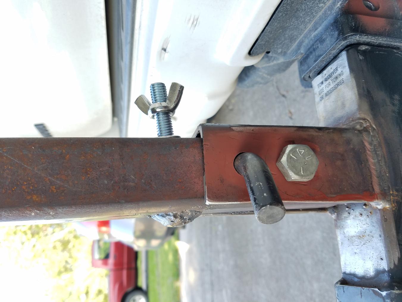

I actually used a 2 piece stacked reciever hitch from Walmart and cut off the top receiver and used it for the mount by cutting away one face of the square tubing to make a "C" channel to hold the up right 2"x2" square tubing which is 3/16" thick. I then used 1"x1" square tubing and 1" flat bar, both 1/8" thick for the jerry can holders. The gussets are 1/4" thick and tire mount plate is 5/16" thick. All stick welded with 1/8" 6010 and 5/32" 7018 welding rods with a Hobart Stickmate AC/DC welding machine. All bolts and pin holes are 5/8".
Here is some pics
I couldn't find a extended hitch receiver locally and didn't want to wait to order one, so I bought this from Walmart, which worked out even better because I used the top hitch for my fold down mount.

Felt that the jerry cans were to wobbly the way I had it designed, cut them back off, thinking of inside cab mount.
(Currently removed tire carrier)
